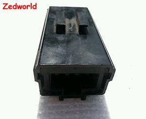

There is s bulb failure module clipped ( or dropped down and hanging on the loom) on the outside of the rear drivers light. these can fail on one of the outputs, if you power check which input does not have an associated output you can link them and take it out of circuit and get the lights working again, or get a replacement unit and just plug and play.
