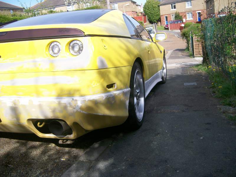

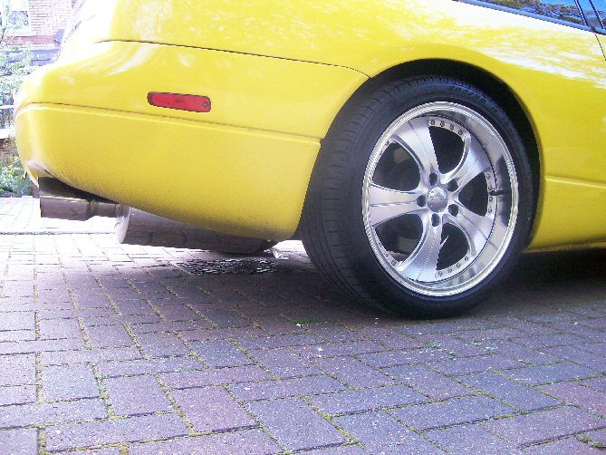

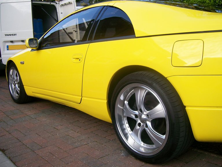

Hi mate, you have the same wheels, cool, they are quite rare now. Ive been trying for ages to locate the centre caps as the chrome plate on a couple are beyond polishing lol
They are 18" front are 8.5 with 245 and rears 9.5 with 265 tyres, they are usually stamped on the inside of the rim, might be worth taking a wheel off to check. They are the CO53 model in hyper silver.

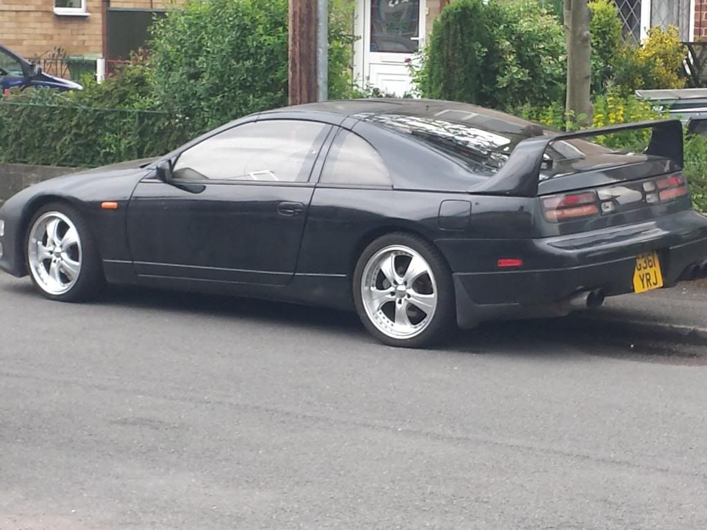

yes I have lost a center cap too. They are nice wheels when clean. But im trying too find out what limit tyres I can get away with ie wider on the rear maybe a tad lower profile.

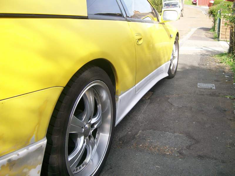

Bodywork is hyper primer :lol:
I have 5mm wheel spacers on the rear and 20mm hubcentric spacer for the fronts now so they fill the arches thumbup1.gif
Look really nice on a black zed :thumbup1: you dont want to go too wide on the fronts i find 245/40 perfect the rears you could go 275 or 285 at a push, mine are 265/35 x 18.
mine are in need of a refurb. up close they look a bit tired and crap. yh fronts ill probably keep the same rear i was told a could possible get 285's at a push. i takeit wheel spacers are safe then? iv hear mixed reviews. might get myself some just to fill the arches a bit more.
Spacers are fine up to about 10mm, then you need to go hub centric, which bolt to the disc first then the wheel to the spacer.
My wheels need a refurb, all those fake allen head bolts the chrome plate has come off and the rims are really pitted through the lacquer
