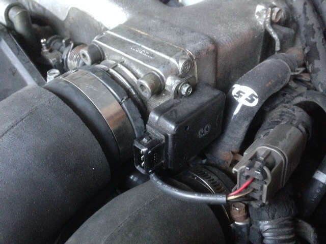

Ok where is the tps exactly?
Mounted on the side of the passenger side throttle body graham. Black box with wires out the back

Did you try the grey connector as my original post?
You can see it in your picture.
