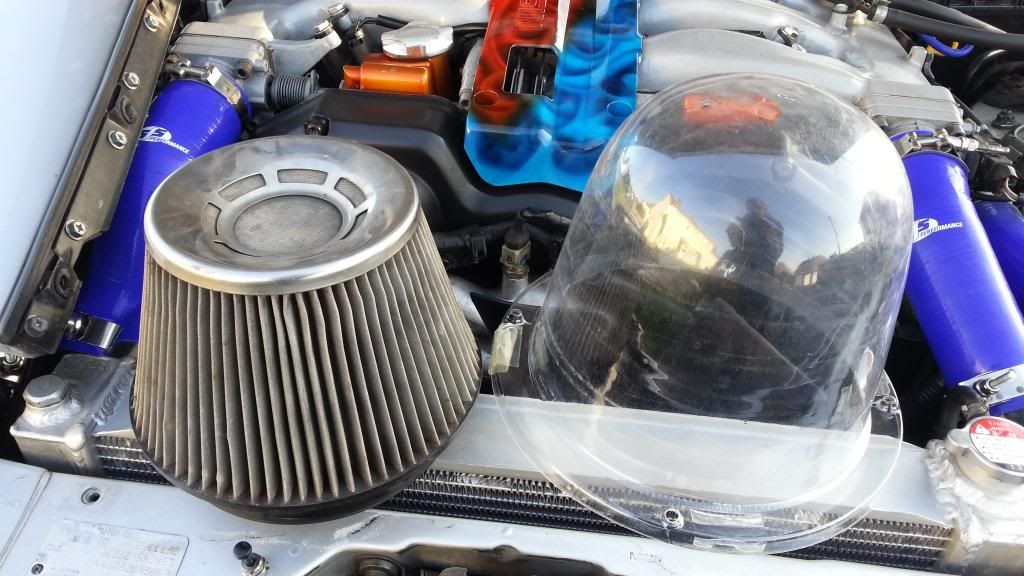

Any other pictures or ideas you guys have got as it pisses me off if I have to take the car out in the wet, this is the filter I have, it's a Blitz SUS:
I also noticed those side scoops are possibly throwing rain at it from the sides?

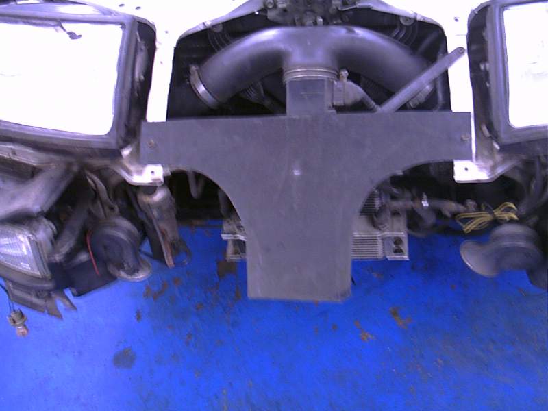

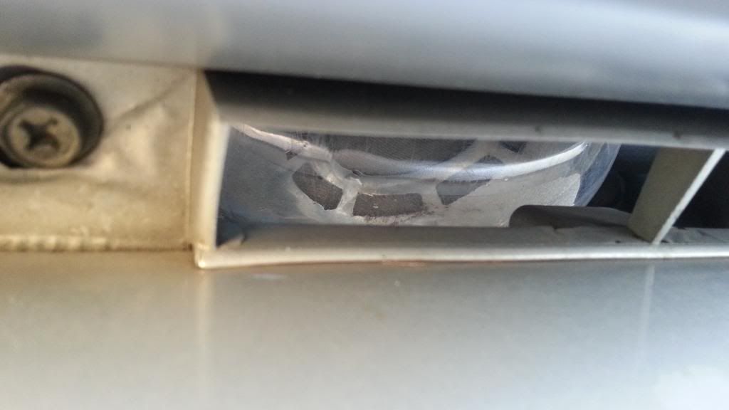

I am missing the bumper splash guard but can't find a decent picture of it... I gather this isn't the belly pan right at the front? As you could still see my filter in the top horizontal vent on the bumper when looking from the front even with that fitted?
The splash guard is part of the front bumper support bracket, the one that houses the fog lights, the ribbed looking thing in the pic you posted, you could also make one using half a plant pot, plastic of course and nearest size to the bottom of the cone filter.
One here http://www.ebay.co.uk/itm/300ZX-Z32-PARTS-FRONT-BUMPER-STRENGTHENER-SUPPORT-BAR-/380888876396

I tried to angle mine down as far as i could, I even rolled up the spash guard to make sure the 2 Apexis were in the basking shark mouth bit, In a (clearly misguided) attempt to get an additional 1.76bhp of airflow. I have had no stumble or anything but may look to relocate them slightly :blush: :oops:
Ok, I've had a play.
Couldn't mount a pot on my blitz sus as there is no where to drill out a hole without messing it up.....
Not sure why but the car seems 25% quicker, I cleaned the maf with contact cleaner too, the thing just wants to rev really fast and flies right up to around top rev range.
No stumbling really and idle is sweet.
Hopefully this is the end of my wet maf syndrome.

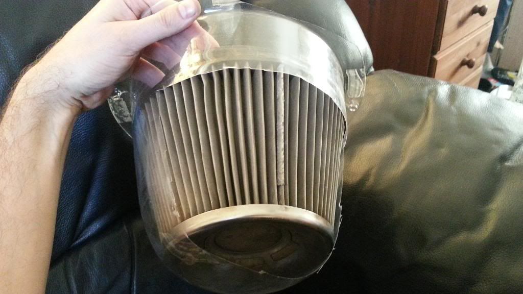

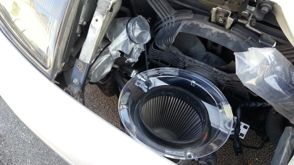

I couldn't get a black pot, plus they all had holes in the bottom.
This was some sort of medium sized grow your own bulb thing that goes over the plants.
Second to last picture - I have pulled the plastic down now past the bottom of the cone as this would of caught the rain still, so front part is now completely covered :)

I was getting a wet filter as water was dripping through between the nose panel and bumper , made a little shield and it cured it .
Someone called em zed pants !! but it works :thumbup:
