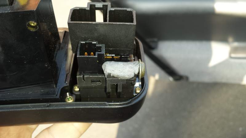

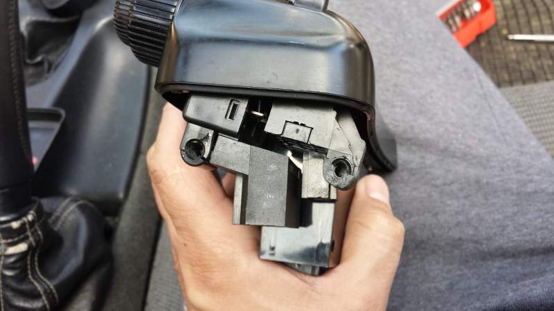

on the light controls one screw hole was broken in half and wouldnt hold tightly so i used some quick steel and made it whole again :)
it was quite simple fitted the screw all the way in its tightened place and then applied the quick steel over the missing half. then left i to dry and wallah!
