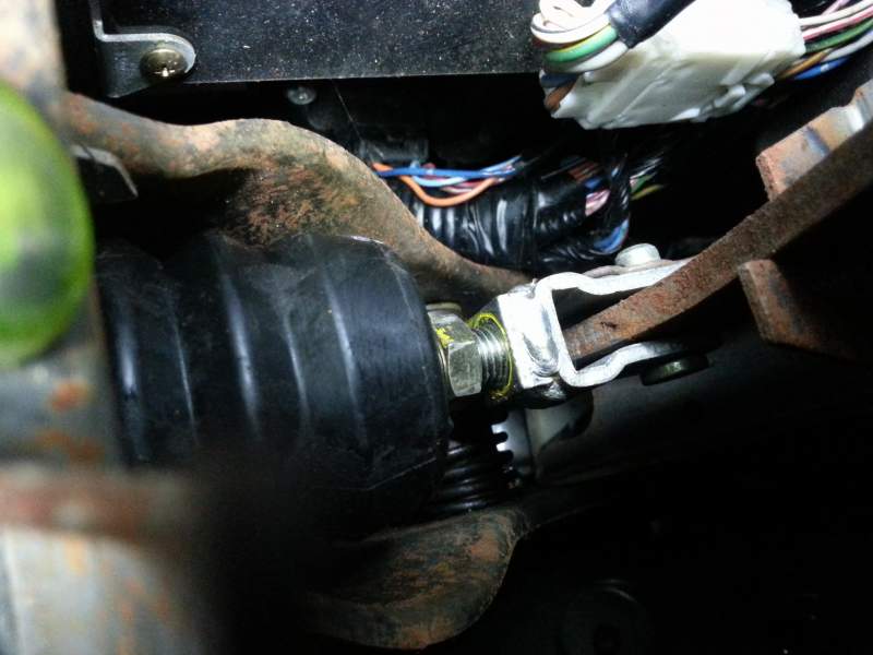

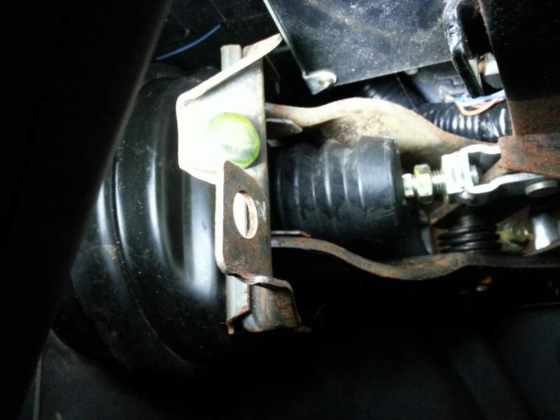

Mine dont look like that in the pics, mine has no 10 mm nut to turn because mine has a fine splines going in to the cylinder thing. so it looks to me the only way im going to do this is to take out the pin on the peddle wind the whoule unit out of the nut about 5 mm , them try to put back the pin and silver bit thus making the brass bolt thing longer, i think. heres 2 pics to show that there different, mine is a 1990 tt uk model, thats prop were the diff is thou maybe?

ok in your pic its a 14mm nut .. but u can adjust the clutch some more as u can see there is still some thred poking tho the collar ..
but remember u only need to keep adjusting untill the clutch feels better .. dont do it to much
once its ok .. Move the nut to the U collar and lock the thread off

I found the same on mine.
Instead of removing the link, I adjusted the thing by using long nosed plies and gripped on the splines.
Fiddly I know, but saved any dismantling.

didnt want to do this because i dont know how the rod is connected in the clyinder because of the splines on it , it must get keyed in with the splines. is the rod just sitting in a threadded splined whole, dont want to cause anymore damage to somthing else?
The splines on the rod are a red herring, they do not engage into anything, the rod is free to turn and it not directly connected to anything and is just a push fit into the clutch booster its is fitted in. Turn the 14 mm nut until it get to the spline section, from there when you turn the 14 mm nut it will turn the rod and this will make the road longer between the clutch pedal and the booster.
Once happy with the setting the 14 mm nut needs to return to the lock position however its likely it has tightened on the rod now, so what you do is half depress the pedal with your hand, push hard\sideways on the pedal so locking the rod, and then with spanner move the nut and it will release, you should be able to spin it in to position and tighten.
Jeff TT
Thanks thats the info i was looking for ,so i now know i cant damage the clutch booster. cheers
