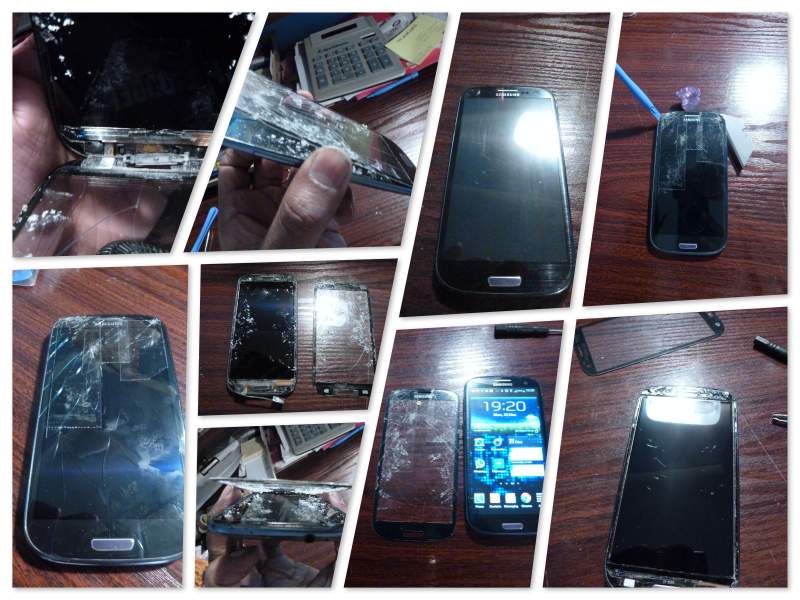

I did a repair on my S3 yesterday, coincidentally. I only broke the front glass though.
Replacement cost £5 delivered off ebay and took my 2hrs (taking my time) to change it over. It's not quite as good as new but a huge improvement on how it was.
