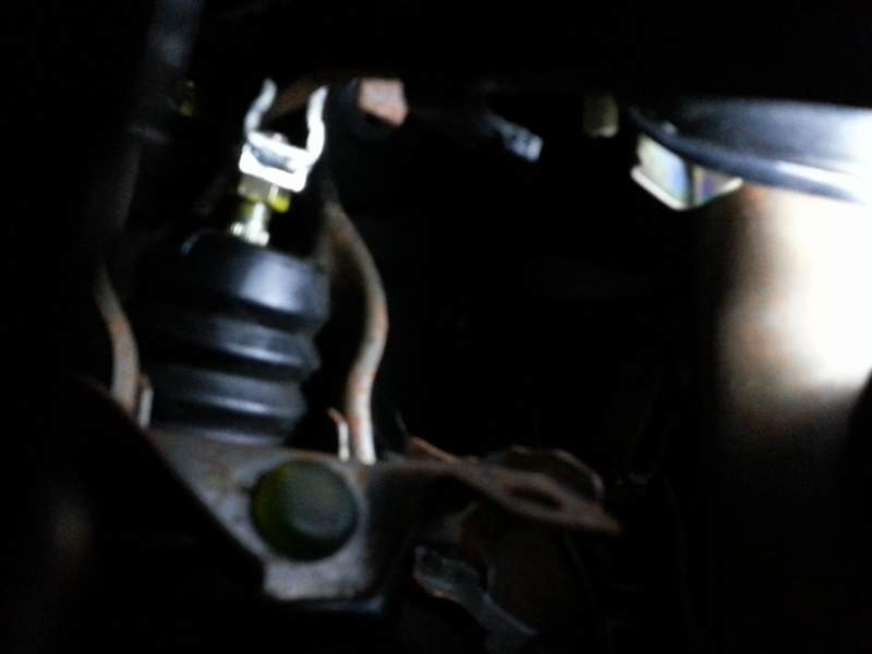

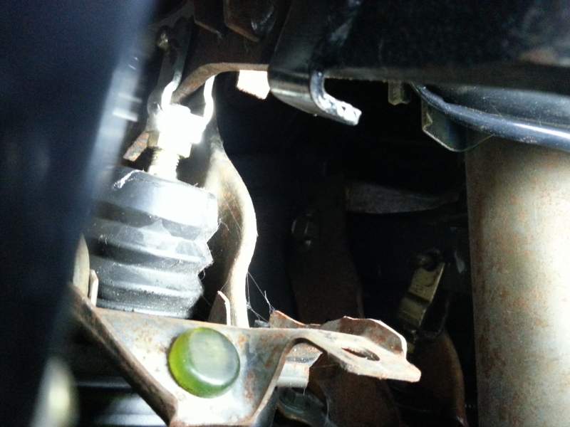

Right these pics should be the right nuts to do.yes.
I cant see right up there yet i guess i got to get the heater plastic thingy out the way. But there does look like there is about 10mm clear outside to the exposed nut to wind in or do i need to make less bolt visable buy turning the other way.im talking about the nut whitch has yellow paint on it and that bolt that goes through that.yes?
oh and before anyone says no the children havnt droped a green fruit gum down there. lol
