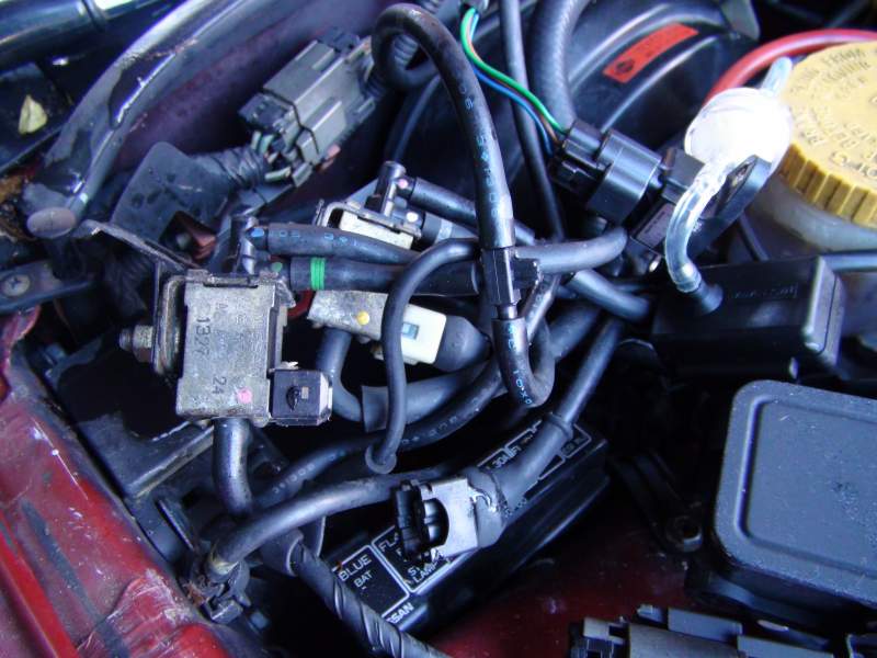

well guys got another problem, when my 300 is idling it's fine but as soon as the throttle is opened about 1mm it runs like a sack of..... every time there is a click from a solenoid buy the master cylinder, i unplugged that solenoid and the problem is now gone I'm assuming its for the aiv or maybe the egr, both of them i plan on removing when i install my new turbos, just want to make sure unplugging the solenoid wont affect anything.

Have you got a pic of it, just so we can be sure? It's been a while since I removed mine :)

this is the solenoid i unplugged that was making it run like crap, with it unplugged it runs fine probably a vac leak somewhere but will be removing egr and avi system at some point soon

As you say mate, it's probably a vac leak somewhere. Your best bet would be to do the AIV delete first and see if that makes a difference then move onto the EGR delete.
i removed the AIV's yesterday and all is good :D and i replaced a load of vac lines too seems to boost better now, that might be my imagination not sure :laugh:
