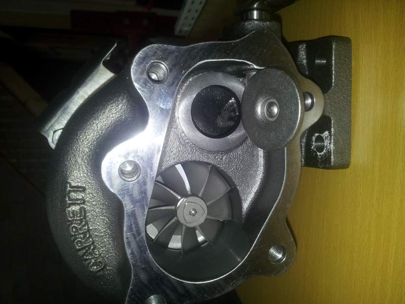

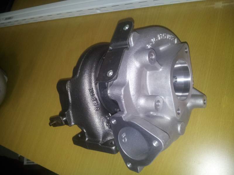

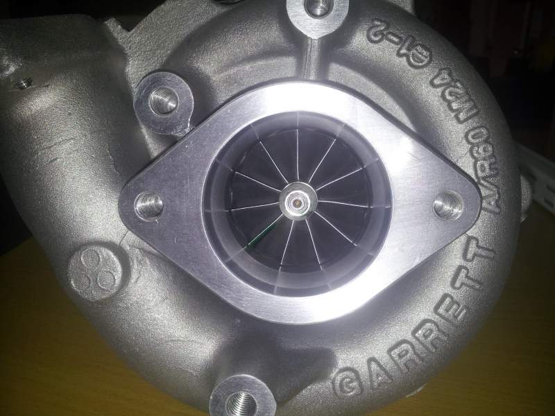

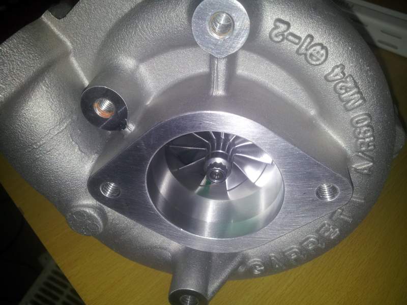

So here are my GTX2860R turbos straight from the US of A
I'm not an expert on these things, but Steve at Siverline who sourced them for me tells me that the impeller half of the housing is a special custom one quite like the 'stock' Garretts so they fit straight onto the car without any adaptation. This is an option that is available in the US (but not over here apparently) which also means the impeller housing is slightly smaller than normal for the GTX2860, so these turbos will spool faster than normal at the expense of a little top end horsepower - which is more suited to a fast road car and are also easier to fit.

IIRC Markderby has the GTX2863's which are the next size up. I don't know if he has the machined out T25 front housings on his though
