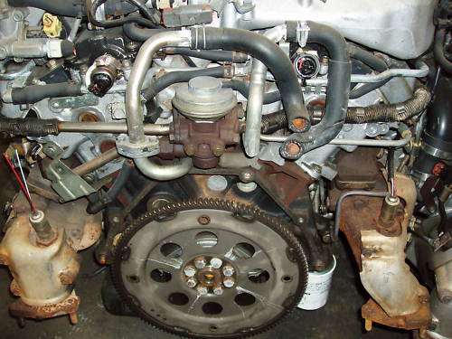

there is a hose behind the engine that gives the heater core the hot water to heat the interior, check to see if its been looped to bypass the core, if it has more than likely the matrix has burst and will need changed
You're not kidding, Lexx!! :lol:
I've had a quick look just now and I could see a hose connected to the firewall roughly dead centre of the car - I'm assuming this is the main heater hose? If so, it doesn't seem to be looped anywhere so I think my next stop will be under the dash to check that everything's connected under the steering column.
Failing that, I dunno...!!
Si, there are plenty of post of fixing the heater code and by-pass with pics... do a search and it should give you a better idea of what to look for..
There are two hoses coming out of the fire wall behind the engine, if they are not looped together (engine side) then it could also be your heater thermostat that is located behind the glove box on the A/C unit, you cant miss it its fed by a large wire into a metal bracket

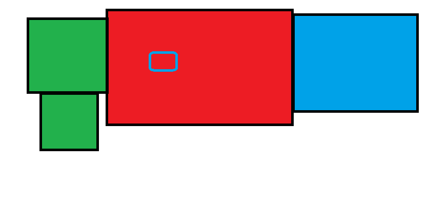

Now with the help of my technical diagram below (made just now using MS paint i might add)
situated behind the glove box and dash is the following,
Green blower motor
Red A/C cooling box
Blue Heater matrix
Blue box, is location of A/C thermostat thingy ma bob. if this is faulty, then it doesnt open the heater matrix to allow hot air / water to flow through it (pretty sure thats how it works, could be wrong, but ive had this fail on a pug 406 before and changing it gave me hot air back)
Cheers Gerry and VS :) Gives me things to look for.
