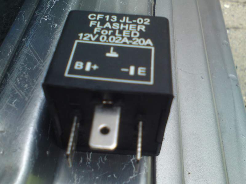

I couldn't possibly be more helpful than this !!!!
Here is a photo of mine, so fit this and you can then do what you like, remember though you lose any warning that a bulb is out :no:.
And this looks like the same on ebay does it not...cheap as chips :wink:.
http://www.ebay.co.uk/itm/Module-CF13-Fix-LED-Signal-Light-3-Pin-Electronic-Flasher-Relay-Error-FAST-Flash-/230838266020?pt=UK_Motorcycle_Parts&hash=item35bf0868a4
Just purchased this........ Many thanks matey :)
