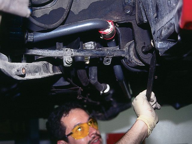

Hello everyone,
So when investigating my Zed pulling to the left we found that the tie rod end bushings have worn out.. My mechanic can replace teh bushings which he said would be the cheapest options but I can't find any bushing for Sale on their own? anyone know a supplier where I can buy just a couple instead of a full set etc? Otherwise I may as well just buy the full tension arm, which brings me to my next question..
Is it worth upgrading tension arms? I know there are some Tien ones I could pick up and replace the whole arm and have allegedly performance enhancements for responsiveness/stiffness?
Best, William.
Yes what you need is poly bushes to replace the worn standard rubber ones, as can be seen in the picture below
with these bad boys...
fitted to the arms they look like this...
[ATTACH=CONFIG]72743[/ATTACH]
