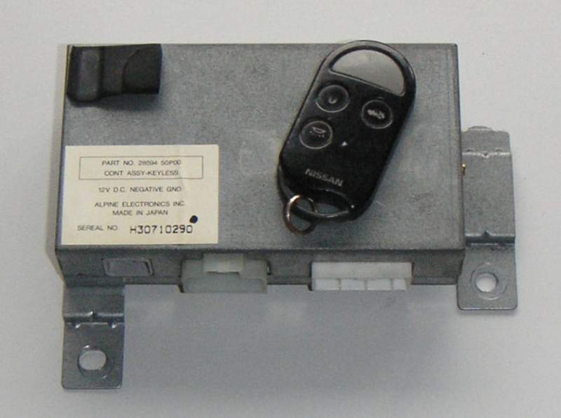

You should find this in the passenger side footwell (it's the control box) and the remote is sitting on top of it.
By a bit of googling you can find replacement keyfobs from US http://www.keylessride.com/order/chooseremote.asp?make=Nissan&remoteyear=1994&model=300ZX but since the remote uses a radio freq not legal in UK, I didn't bother. Just took it out and had a proper UK one put in. This was from a JDM Series 3 built Dec 1993 and as far as I can remember when I looked at the time, the remote access was the same in US and Japan. Later cars didn't always have this - my Series 6 doesn't.
HTH, Cheers, Gio
That's Gio. that's the kind of info I was looking for.
I don't remember seeing this in the foot well when I last looked. but will check again.
