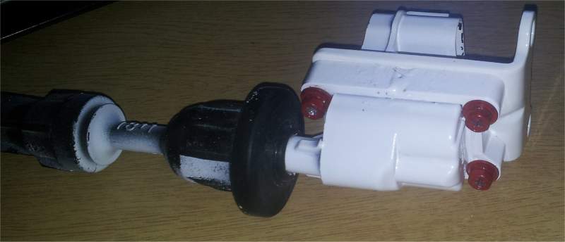

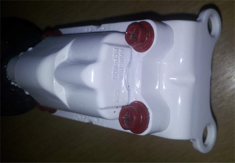

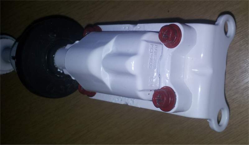

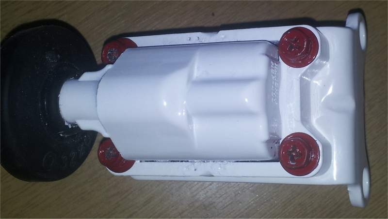

I decided to spray my spare set of coil packs white, which worked a treat I think (see pics)
I also sprayed the little bolts that hold the brackes onto the coil packs in red - which matches the colour scheme of my engine bay nice
In the meantime I got the brackets off the coil packs powder coated - which also look great but the stupid thind is some monkey at the powder coaters got coating into the threads! So I managed to get one put back together by scraping around in the thread with my screwdriver and driving the bolt in and out until with some force I got them far enough in to hold the bracket tight
The pics look cool (I think anyway) but how best to get the powder coating off the threads in the other brackets??? I have a hew hand tools and a dremmel handy if that is any use
