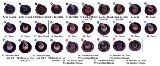

Plug colour
Will try that but was told the map should be fine anywhere upto about 1.7 bar which I'm only running just under 1.2
Turning the boost down won't richen up the AFRs, the Nissan ECUs don't work like that, plus the map that's on this car is good for 12.08@115mph 1/4 at 1.9 bar ;)
Without having the car for a road test at the very least, and preferably for some dyno time, it's impossible to say. Need to monitor AFR & knock, not really worth trying to guess from plug colouration.
