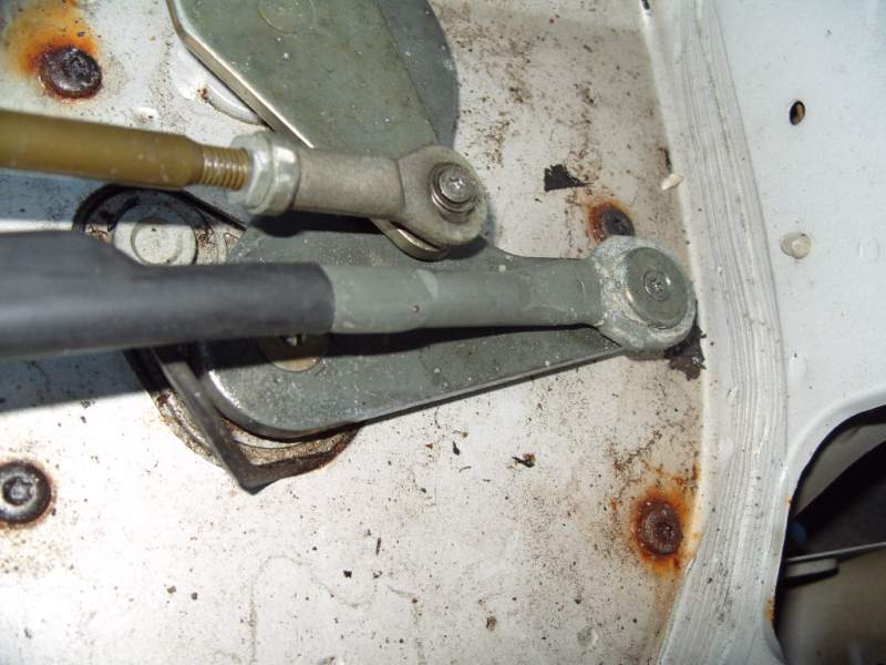

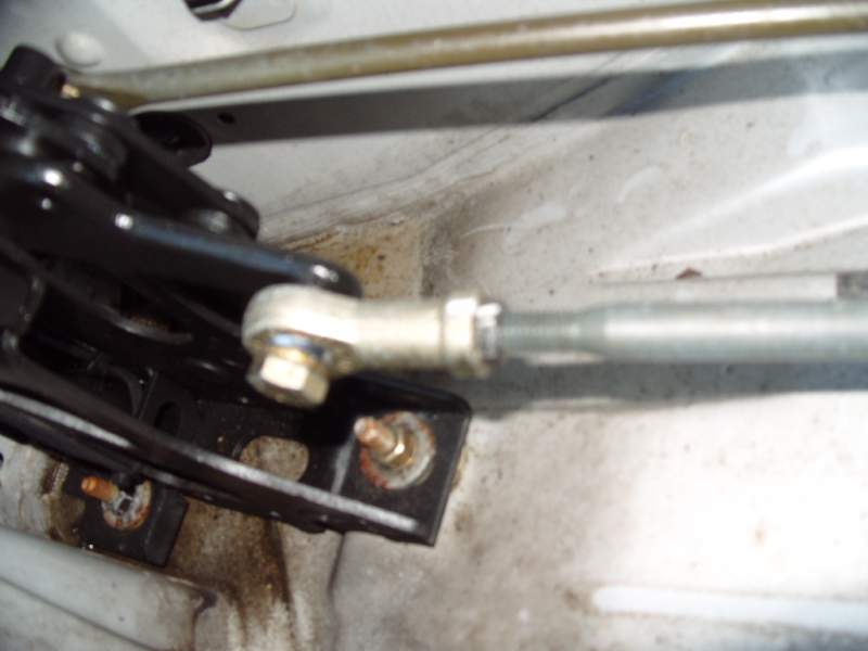

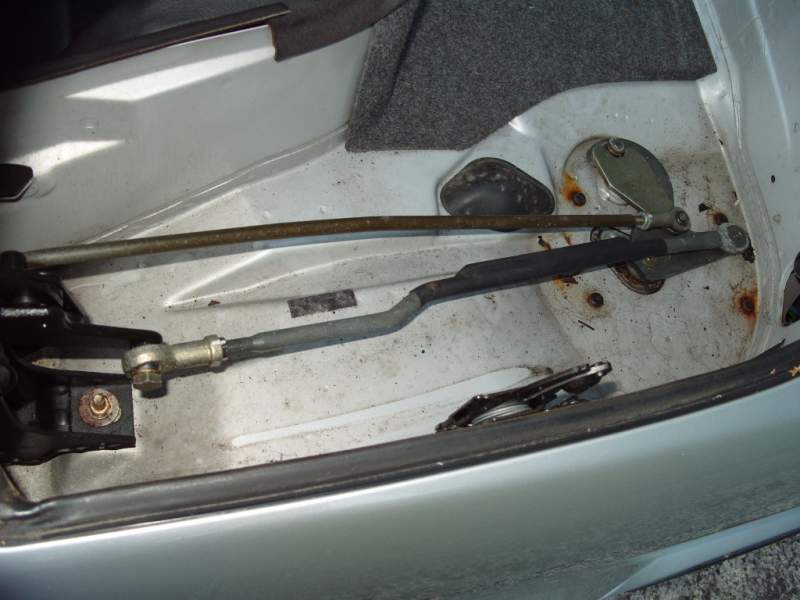

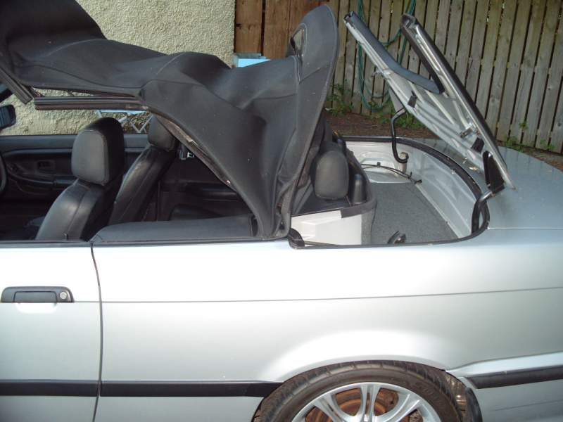

Nice Gaz, how's your roof? Mine needs a little work. Tension straps need doing as the cover catches on the roof and the fabric round the rear window needs looking at, got any ideas of places to get bits as I'm finding that bimmerforums ain't all that.
Mine was the same mate but if you stop the roof when the back hatch is open you can see two rods on the passengers side which can adjust how far the fabric roof pulls back.As for roof parts or repairsI would just Google it to see who is close to you.
Cheers Gaz I'll have a look. I was lead to believe they were elasticacted straps. Probably read it wrong.
