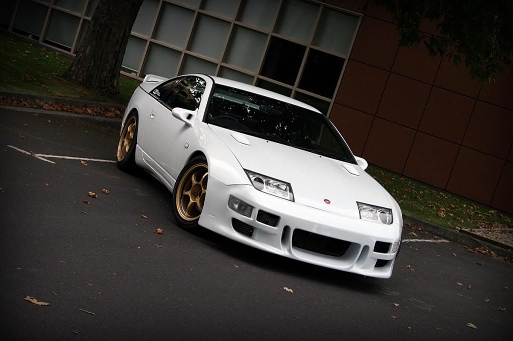

Towards the end of last year a very rare 300ZX popped up for sale on the other side of the country. A 200o model, arctic white, twin turbo, 5 speed, version S, slicktop. Sadly it wasn't in original trim & the condition wasn't perfect. That said, I couldn't pass up the opportunity of owning such a rare 300ZX.
This is how she after being delivered via truck, train & boat. Already had a Stillen front, Bomex wing & 17" ADVAN wheels.

Very nice ! If I had the opportunity, a 2000 TT Slicktop would be my ideal choice, and it looks stunning in Artic white (I have a bit of a thing for Bright white cars lately).
I've been following this on the Oz site, very cool car. I love the 2+2 you sold as well, thats an extremely good looking car:thumbup1:
Very nice. Personally not keen on the ugly Stillen front though, it doesn't even appear to fit very well.
Very nice slicktop I have a 1991 jdm tt manual slicktop and I've noticed a few diffrences no hicas solenoid no digital climate control also my expansion tank and filler neck is on passenger side of engine bay .
Yeah, lovely car :drool:.
You're always going to get folk finding items not to their own liking even on the ultimate spec/year, personally I would of kept stock mirrors and the airbag steering wheel :yes:.
Stunning car buddy, love your old one too

Thanks all. I would have preferred the stock steering wheel, as well as the stock front bumper. But sadly both had been replaced prior to my purchase. This car is no where near as neat as my 2+2 was/is. But I am slowly but surely doing what I can to restore her to showroom condition (or close to).
I don't plan to baby this car either. I bought it with the intention of doing track days which will upset some people. But cars are for driving and enjoying, not locking away and admiring (though I still admire it every time I look at it haha).
