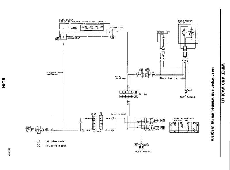

Rear wiper not working after checking fuse...
As above, anyone have any other advice on this please? Thanks

Mine doesn't have a rear wiper so I don't know ... but is there a relay?
can you check to see if there is current to the rear wiper and also check the earth...

Dave was wondering if there might be a relay...thats why asking on here so can get some light on the matter, bad enough to see out cos tinted, let alone in rain with no wiper :(
Thanks mate, will ask my mate to look as I aint a clue,lol
Get a volt meter/fluke, voltage tester and Check to see that when selected on, that you have power getting to the motor. If no, then go for the relay first. You could bridge the relay holder to test the circuit and/ or use the fluke to see if there is power at the relay holder, if not, possibly switch mechanism.

in behind the stereo console there is an earth connection down on the floor (hump), my auto aerial had issues when it came loose.
have a look there.
