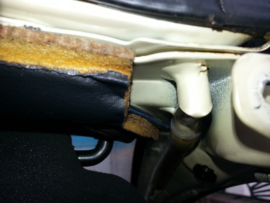

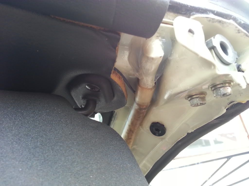

If you do have targa leak you might check this ... as you can see in the picture where targa drain pipe is connected to elbow it`s welded only one side and and that`s where my leak was
a bit of silicone and sorted :)

And after i found it never had time to buy silicone :) so it was leaking for a month :)

That could be the source of my leak as I get a wet leg as water come out from under my boost gauge.
could be mine as well, will check today. good find!
