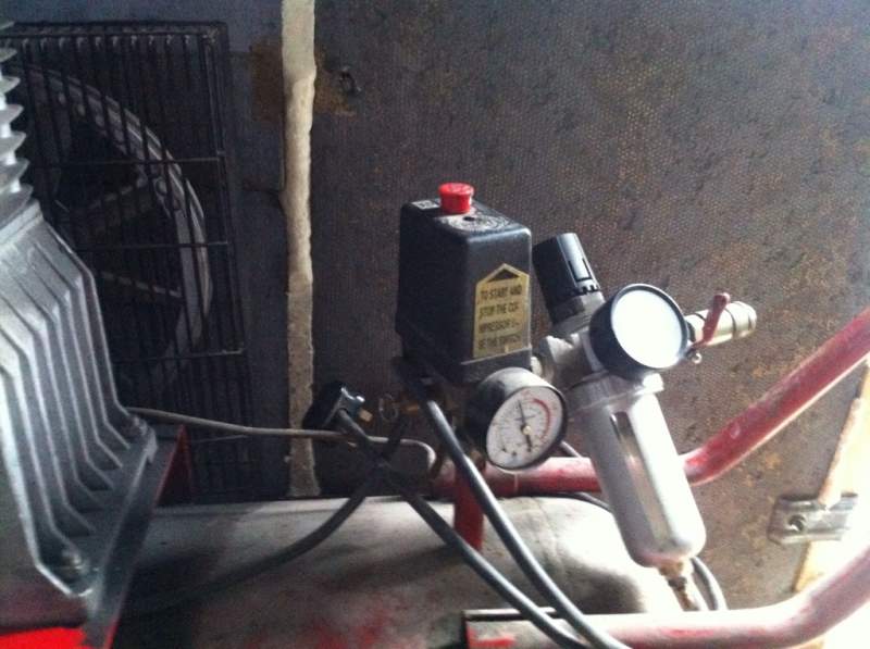

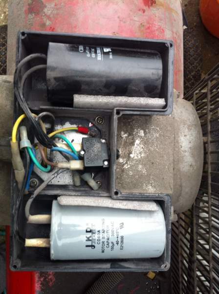

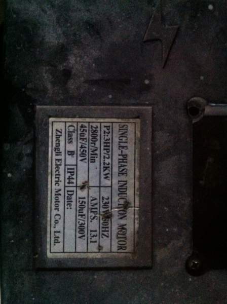

Today it filled up it tried twice to start but kinda strained then just cut out n stopped working again ill post up a few pics of motor ect
Chinese motor and pump mate:thumbdown:...the offloader small air line going to the switch sounds like its sticking and when its trying to re-start the motor is fighting against pressure. Get yourself to machine mart and buy a new start switch or there cheap enough on ebay..you will have to adjust the pressure switch to your desired closing psi by taking the black cover off (1 phillips screw) and on top theres a spring loaded bolt with directional arrows stamped in. By the sounds of your problem its deffo the unloader stuck or next bet if thats ok the start capacitor on the motor.
