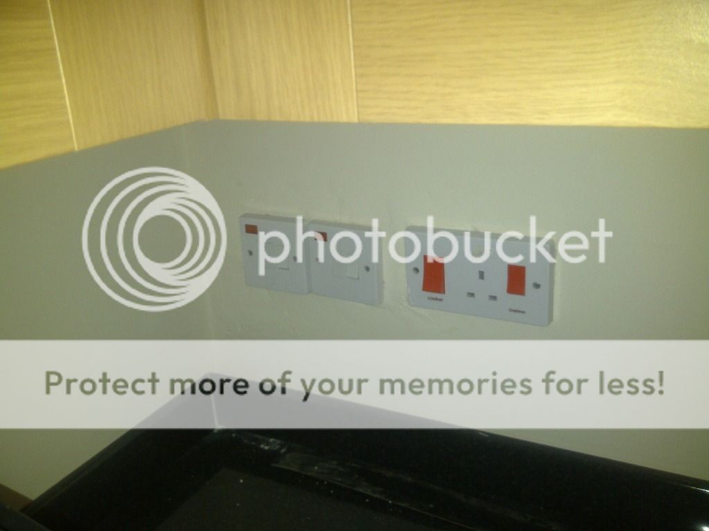

Currently the hob has a cooker switch above the worktop on a 32amp fuse
the oven/extractor was on a single 13amp fused switch at the time that the electrician signed it off, but for some reason my old man decide off his own back despite me telling him not to, to hack away at the wall and add another 13amp fused switch (see pic) in order that the oven and extractor have their own switches.
In doing so (1. It looks shit) 2. a couple of the double plug sockets along the work top now don't work and 3. The electricians check is now null and void and it's going to cost me another £140 odd to get him to re-check it/sort it.

can't spur a socket of a decicated cooker circuit it's a no no,and you have a switched socket on the cooker outlet which means this circuit has to be on a rcd!!! if the cooker outlet didn't have a socket on it it could stay on mcb
The hob is on a seperate 32amp RCD labelled 'cooker' in the fuse box
the oven is on a seperate 16amp RCD via a fused switch, from what I can see the oven extractor fan is spurred off the oven fused switch to a seperate fused switch (both appliances are obviously 13amp), the sparky signed off when the extractor and oven were both wired into the same fused switch. This has since been changed
