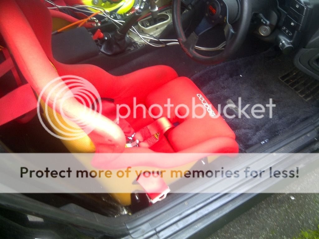

My OMP seats are welded to the OEM seat runner, so i still have adjustment, but they use the same bolt holes as the normal seats, have to admit the weld isn't pretty bud does the job
I had to experiment with 3 different types of side mount (2 x OMP and 1 x Sparco) before I found these Sparco side mounts which provide the perfect seating position for me
