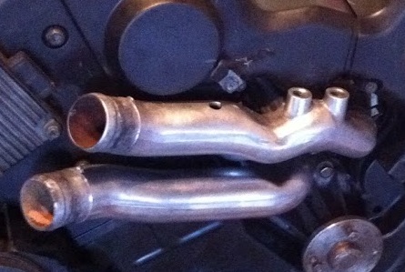

The sensor that came with it Mark will not fit in the Nissan temp hole ( to small) do you know the best place to fit it? Cheers Paul
Hi Mate, take a pic of where you fit it to and drop it on this thread will you?

Just drill a hole, thread it and thats it : dziurka.jpg
Edited by Draxan
Cheers Guys.. its just sooo permanent.. want to get it right.. lol... Thanks...
