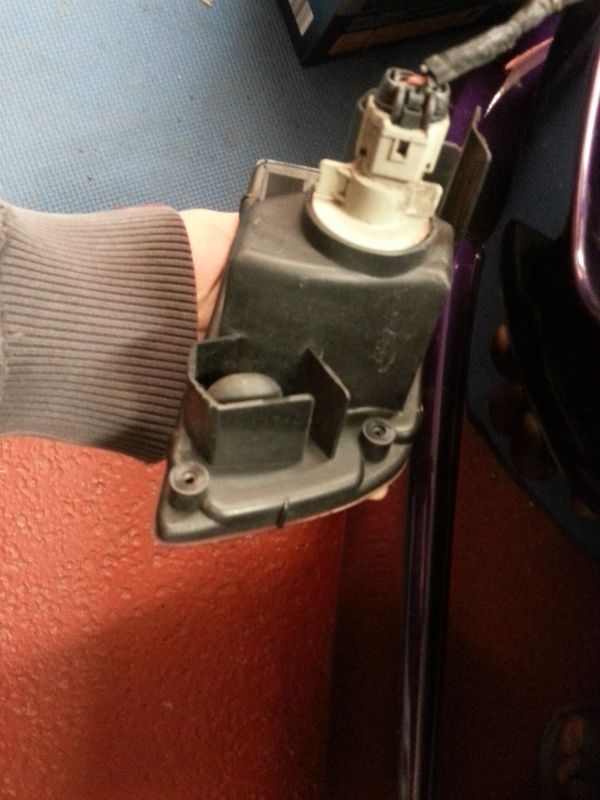

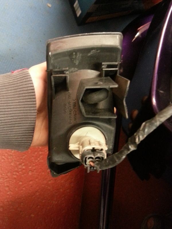

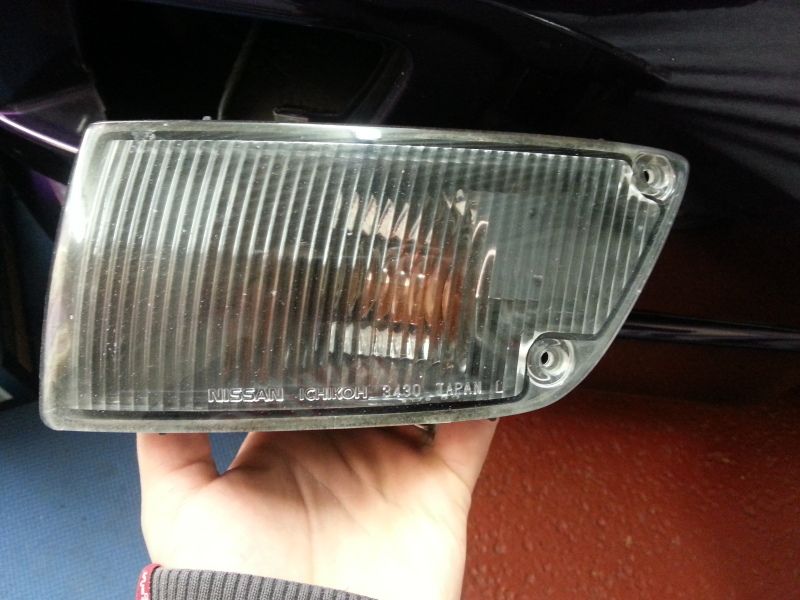

I dont think i can do that mod with my indicators as they look like this:
I will try to get one of them bulb holders and re solder onto existing wires.
Cheers

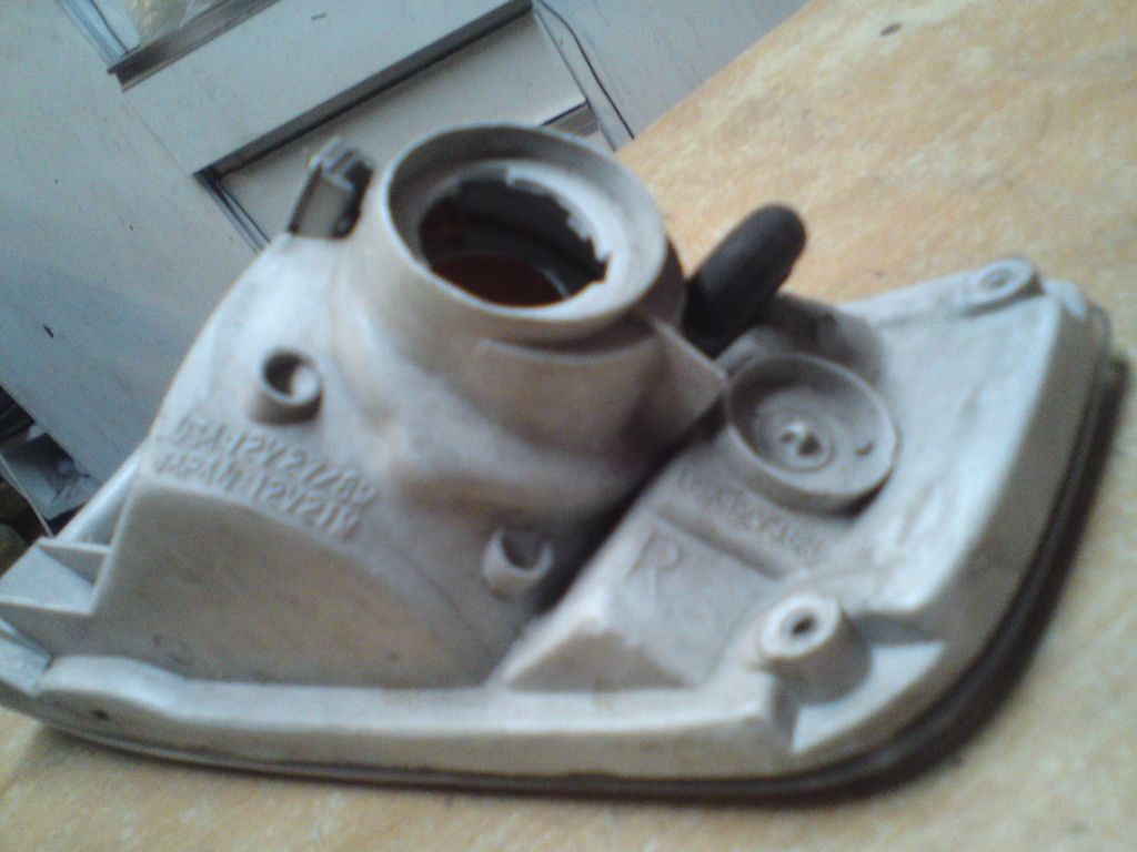

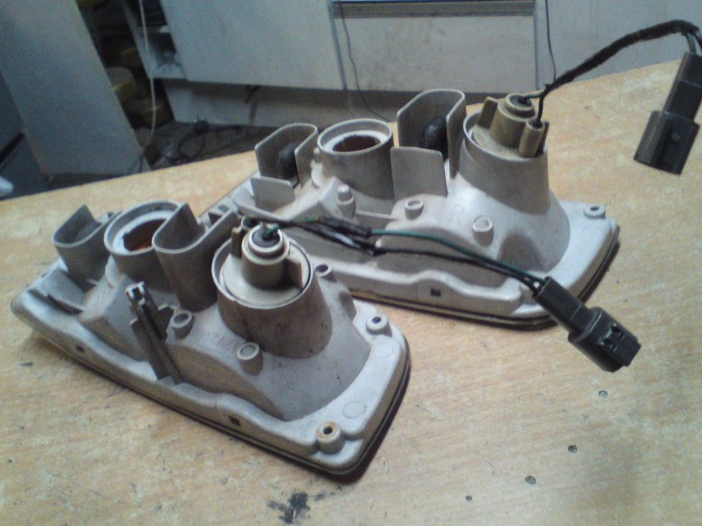

This is the unit talked about above that as you can see as the area that needs dremelling out so you can put in a T10 bulb holder. Yours as far as I can see cannot be done :sad:

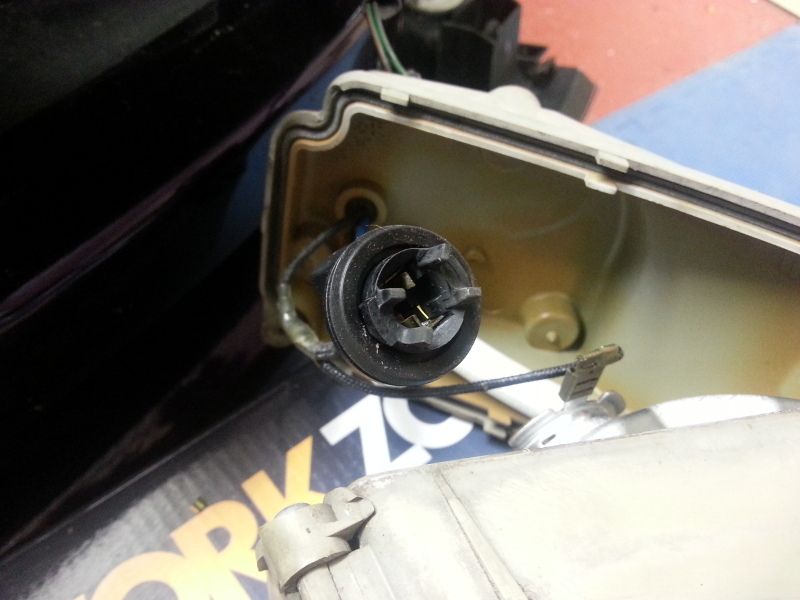

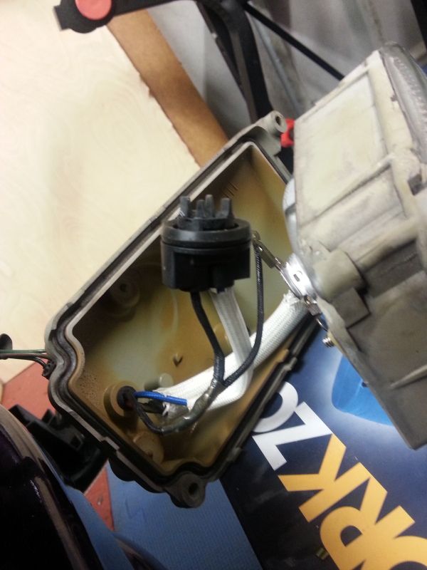

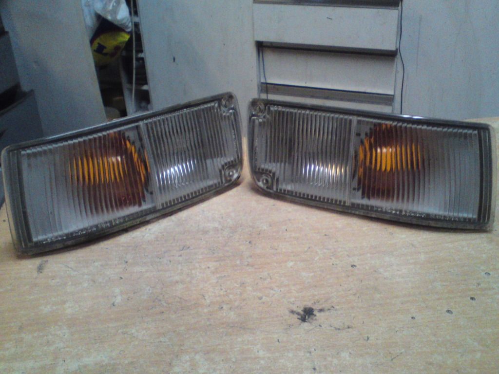

These next two pics are my old ones and as you can see have two perfect full size bulb holders, I was going to keep but as you've given me some rep :cool3: I will sell them but will be £25.00 delivered as they are perfect, will include the sidelight bulb holders you can see plus short loom and plug, also a fancy smd white bulb will be left in each, these are the ones in my sig pic.
FYI, it is possible to open these up and remove the orange reflector although it never bothered me, you would then fit an amber bulb as opposed to a clear one for your winker.
