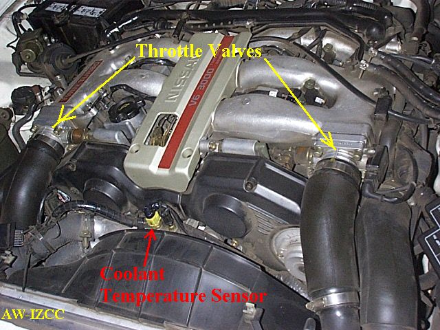

Hi, as Andy said check the ecu temp sender unit first (the two pin one on the front water pipe).
check the connector for corrosion and good contact. if that is OK you can check the resistance of the unit when hot and cold.
Cheers Medallion Man, I will check that. Do you know if its possible to get at the sender without removing the fan?
Cheers
John
yeah... top rad pipe coming out of the block... there are two temp sender units on it....
one is for the gauge (one spade) the other with two spades (on the right) is for the ecu... take the connector off and check it...
if it's OK and or if not and you clean it and still have the problem then undo the sender unit (or test in situ) :)
this any help?
