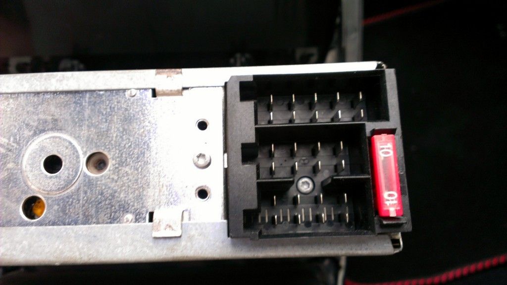

Secondly... some questions about the radio. There's a Blaupunkt Werke Pasadena DJ cassette stereo, serial number BP5781S3765504, and another number on it, 7645781010. It *just* about works; the LCD display is dead though but after fiddling a bit I've got it to tune in with my radio transmitting MP3 player. But ideally I'd like to replace it.

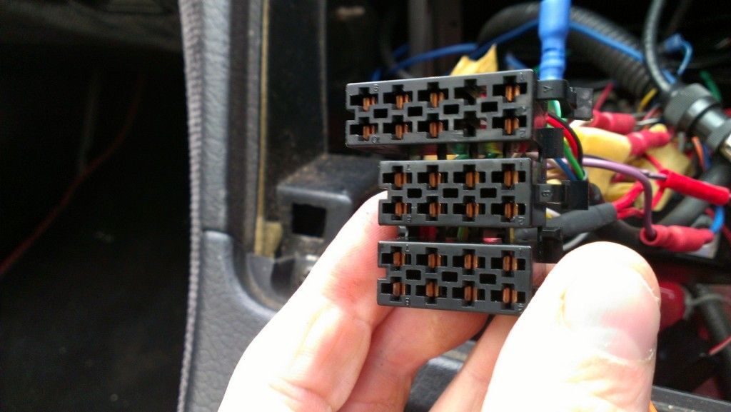

Took her out and seems like a non standard connector block - please see the pics below. The bottom two 8 pin blocks look like normal ISO connectors but they're all stuck together with that other bit on top and obviously wouldn't fit a standard ISO stereo. I can go down the route of getting an ISO connector and rewiring it but was trying to avoid that pain; does anyone recognise the type of connector and know if I can get a simple plug & play adaptor? :confused1:

that is a Standard ISO plugs for Sony and other head units ... 2 things u can do
Buy your self ISO adapter to new radio or
hard wire in your new ISo lead with radio

Mark - thanks, but - are you sure that's a Sony one? I've searched Google images and the Sony ones I can see look like the normal 2 x 8 pin blocks; they don't have that other bit on top. Similarly I searched for 'Sony head unit rear' and the connections on the back don't look like that. Else I'd just buy myself a Sony unit so I could plug it straight in!
Just tried searching for Blaupunkt head unit images too but the only ones I'm seeing are old ones...
The only images I've seen that look similar are the connectors on steering wheel/remote control units! Erm... that's not what I'm after.

yep sure its sony ... old style tho .. not modern like your talking about ...
Ford/jvc load of other radio use the same one as its common connection
the bottom 2 parts look like standars iso but not sure about the top bigger plug any stereo you buy sould have the iso lead/plug if you know how to do wiring you should be able to also buy the opposite end with short cables to splice into your loom
just looking on the web the bigger top section looks like it is used for steering wheel controls/joystick

i think a lot of stereo's have the bigger connector cut out built in but no pins so that connector may work, it would also work if you bought something with a trailing iso lead

The top ones are split into three parts, normally on older vw Audi and vaux hall, they were steering control, amp output and tel input/mute
The bottom are standard Iso

I had another look last night and traced the wires from the top block; all but one (which I assume was a shared earth - went to the lower blocks) went to a funny looking connector - that didn't plug into anything.
So it seems if I have trailing ISO connectors on the new stereo - which, it seems most do; manufacturers seem to have their own connector on the back and then their own cable plugged in with the two ISO 8 pin blocks - then I can just plug it straight in :)
If the ISO connections are on the back of the stereo then I'll have to snap the block up, which looks like I could do with a sharp knife; it's only thin bits of plastic keeping them together.

Piece of pi** - new stereo came today, plugged straight in, hurrah! Thanks all!
