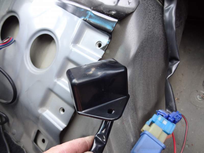

What is this little black box?? plz
this is found behind passenger seat around where fuel pump ecu is on my vert (swb) , any ideas what it is thanks :)

Inverter?
mmmmm, not sure, could be :)
It,s not spliced into the connector on the right of the photo is it? Loks like inverter for ligt up sills spliced into door lamp relay
Yes it is spliced into the relay as in the picture, ....so some bugger has taken the light up sills off before I bought it ?? Lol :-)

Do 2 other wires go somewhere else?

I think it's an inverter for light up sills too
