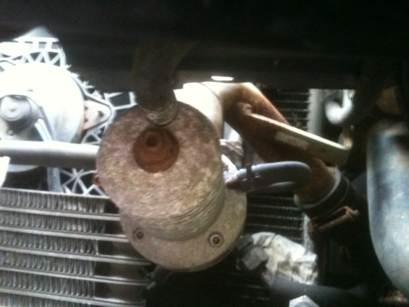

I have these ones mate
Same as mine, if you look at the top of them you have the vac hose connector and next to that a nut, it's the nut you use to adjust them, the red ring with the three different size holes in, are just to change the sound when they dump.
I can't seem to move this nut at all. Which way do I need to turn it? Tighten it?
Membership No 0780
INSURANCE GOOFA
Looks pretty rusty, soak the nut with plus gas or other brand release agent then give it another go. Does the other side one move?
Neither would move. It is the nut I turn and not the Allan bolt right?
Membership No 0780
INSURANCE GOOFA
undo the nut .. turn the allen bolt and lock it back off with the nut :)
That makes sence, thanks.
I still can't move it though lol
Membership No 0780
INSURANCE GOOFA
yeah looks well rusty ... think u need to take it off car and give it some elbow grease

Update on this. So, I've got the nuts off and tightened the screws down quite far. One of them sounded like I could hear the spring tightening, the other I couldn't. Could one of them be broken inside by any chance or should I just tighten some more? At the minute there's only about 2-3mm of the Allen bolt showing (without the nut on).
