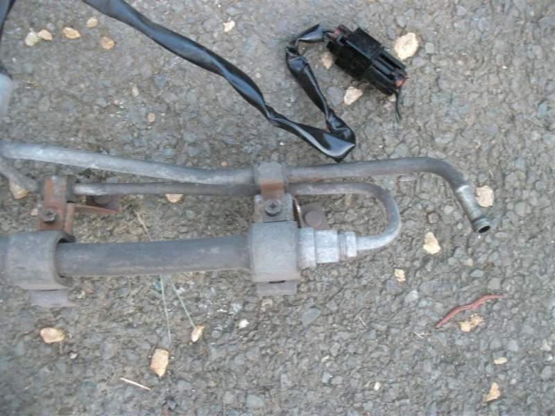

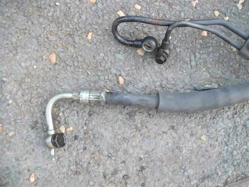

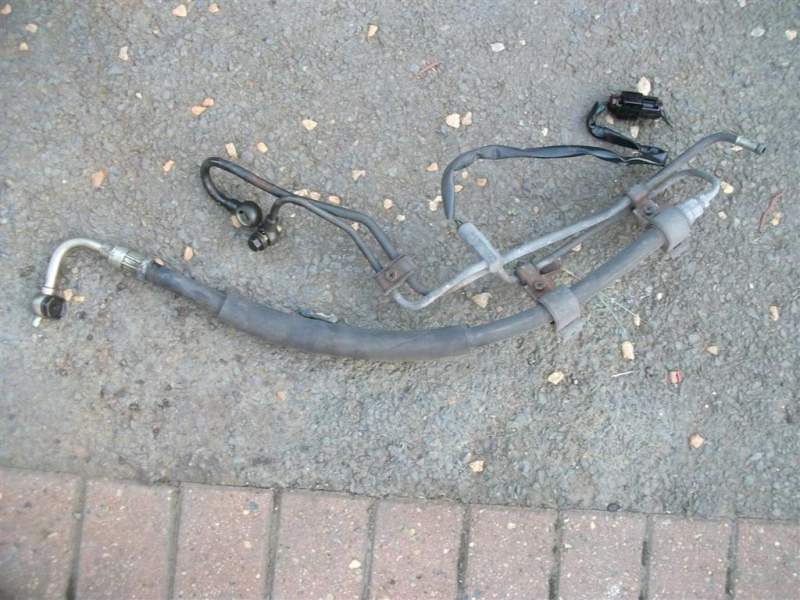

I have one. Only located it late tonite.
I will get more detail and picture tomorrow evening if you still need one.
Pics...........................
NA version I believe. No signs of any leaking and almost no corrosion.
PM to discuss/arrange.
