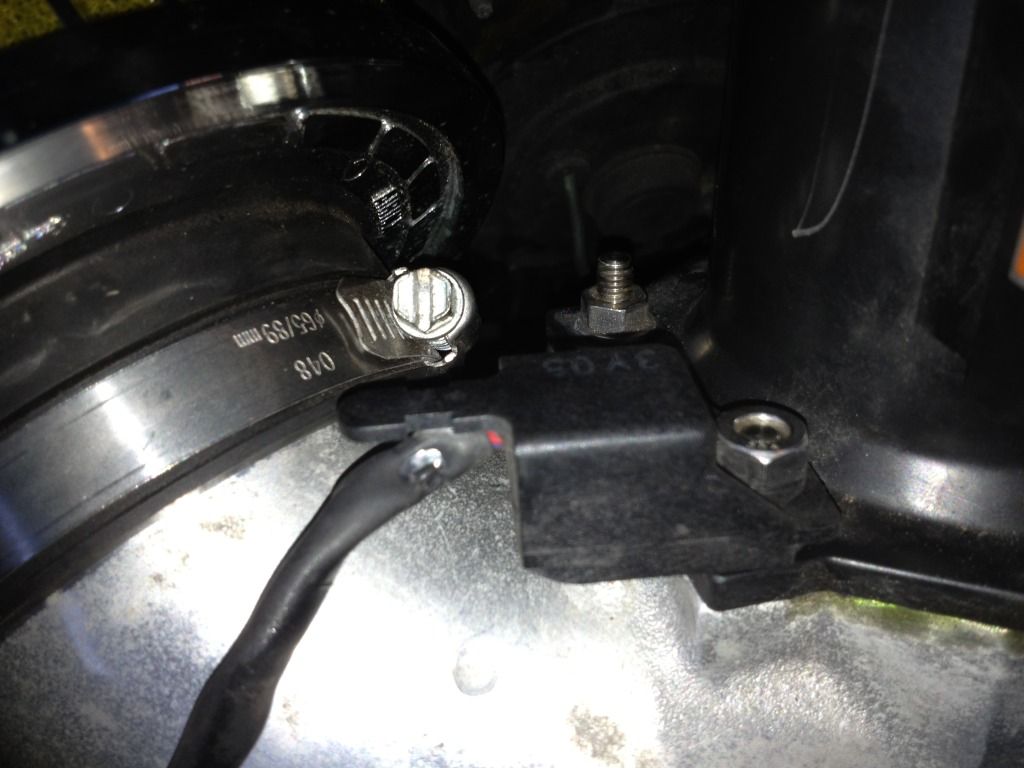

Second little issue is, when i removed the brace bar i found a small black box screwed to it. I have no idea what this is or what it does, so i've relocated it and bolted it to the same place the MAF is bolted to the induction kit (see pic). Will it be OK living there?

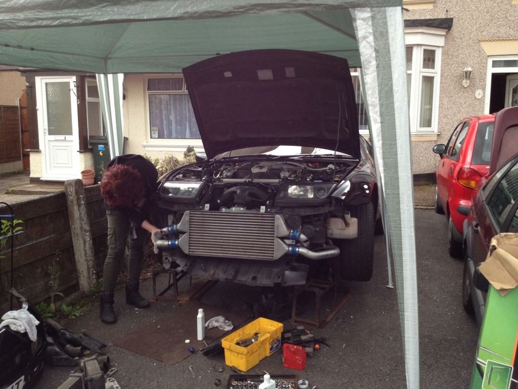

here it is fitted before the bumper. With the Mrs cleaning the shiny bits ;)
Well thats good news Mark :) How do they fit? Do they need bonding in?
The little black box is the external temp sensor for the digi dash display and climate control..........I know this cos I removed mine with the aircon, getting annoyed with it being -86 degrees or whatever outside on the digi display inside now so gonna put it back on at some point! It'll be just fine where you've mounted it.
Great news, thanks for your help guys :) Just need to get myself some ducts now then :) Not sure about fitting them myself though, i tend to make a mess with anything like epoxy or glue haha :p
