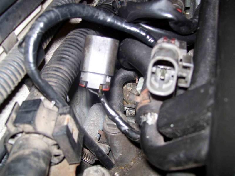

Would someone kindly take a look at this photo please?
I would like to be certain that the cable going down to the depths of the back of the engine is going to the det sensor, and the short one going into the harness is going to the ECU.
It's just that I have been following this link so as to test for the correct the resistance! and unless I am going mad, (which is not surprising) the connectors appear to be the wrong way round?
http://www.zhome.com/ZCMnL/PICS/detonationSensor/detonationSensor.html
Assuming that they are, I am measuring 500 k Ohm resistance to the ECU and also getting 500 k Ohm to the det sensor! My understanding is that the det sensor should be reading 1 meg Ohm resistance or close to.
I have run data scan again only to discover that the car has started with code 34 the last 24 times. AArrrgghhh
As I am only getting half of the stated resistance, could this be the connector or is it definitely the det sensor?
Also,
Should I get 1 meg ohm across the 2 pins on the det sensor?
I can get 500 k ohms from 1 pin to earth, but nothing across the pins!!!

Same link as I refereed to earlier, still convinced he has marked up the connectors wrong Mind you,
I am so miffed with this I probably can't see things right.
Looks like I am going to have to remove the plenum etc' and replace the sensor!!
Looks like a nightmare to me.
