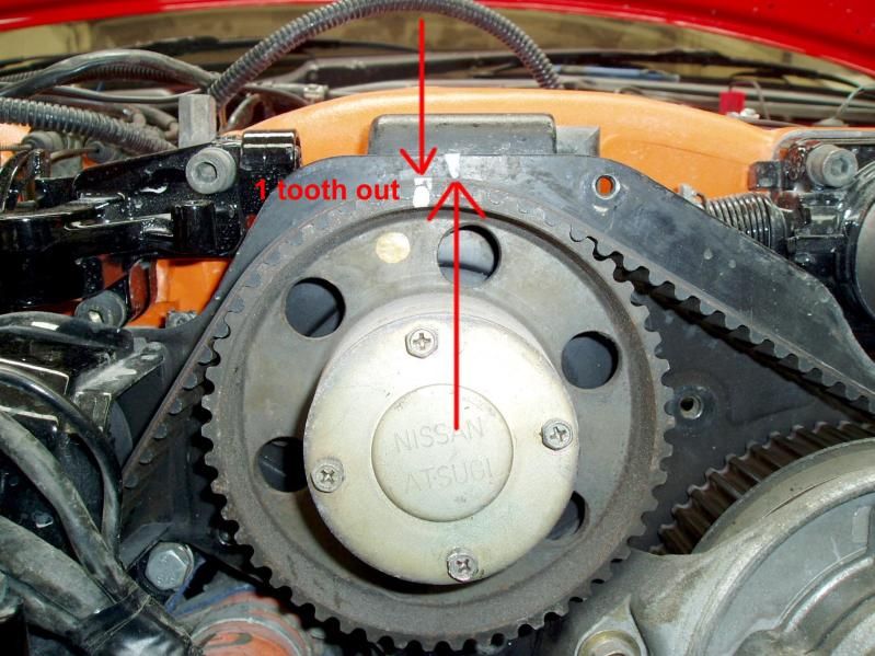

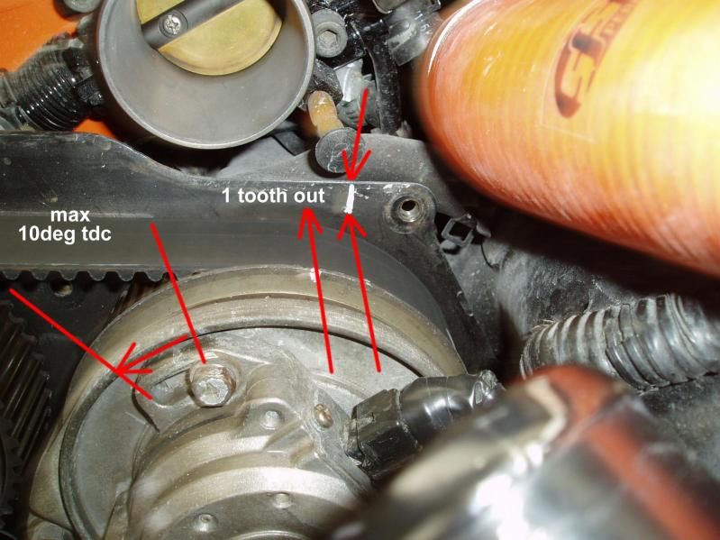

Among many issues have found the main cause of your engine running problem, pictures below, inlet cam and exhaust cam wrongly timed, correct ignition timing of 15deg tdc cannot be achieved, who fitted the cambelt for you? called your work today and left a message with one of your guys but not sure he understood who I was, need your ok to carry on.
