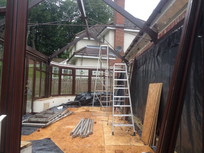

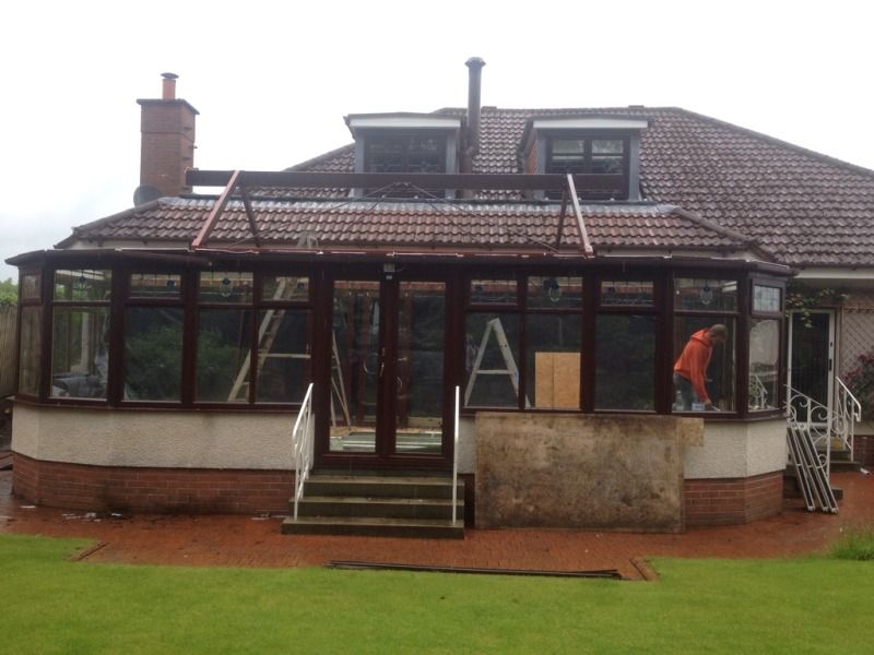

Day one of dismantling the conservatory and all is going well roof of trims removed so getting there has been easier than I thought lol
Fook me thats huge, probably take up my full back wall, might even stick out a bit at the ends.
You could hold the Scottish Regions Xmas bash in that lol, hang on you could have the xmas bash in a phone box
