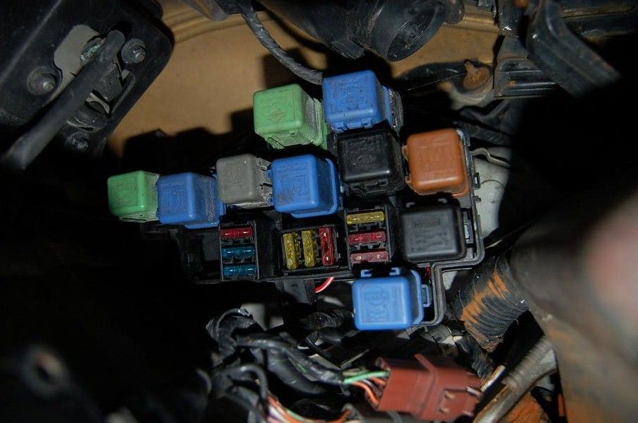

I'm still trying to get to the bottom of why my NA isn't starting. I have got to the stage of checking power and function of relays and took some relays out of my TT to try, but on my NA instead of an EGI green relay, it has a bank of 3 fuses? The fuse box didnt come with a cover so I can only check my TT one, I wondered if this was correct or if someone has been swapping things around hoping that I'll never be able to get it to run again lol :blink:
This picture shows the EGI green relay and its position, but as I say this isn't on my NA its just a block with 3 fuses in.
I have an N/A, just been out to the car and checked and it too has the EGI relay, so looks like someone has tried to modify it to do something else at some point.
thanks for checking graham :thumbup: although it definately sounds like its been altered, which could be a bit of an arse :(

This is mine...
definately not the same. will have to have a dig around tomorrow and try and work out WTF is going on. I also notice that my IGN COIL relay is black and not green?
and the other pic again for comparison:
