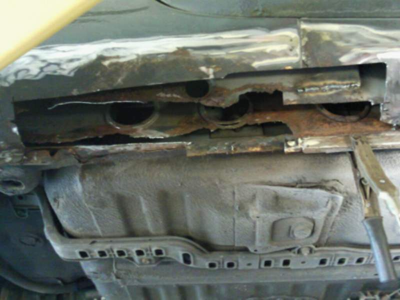

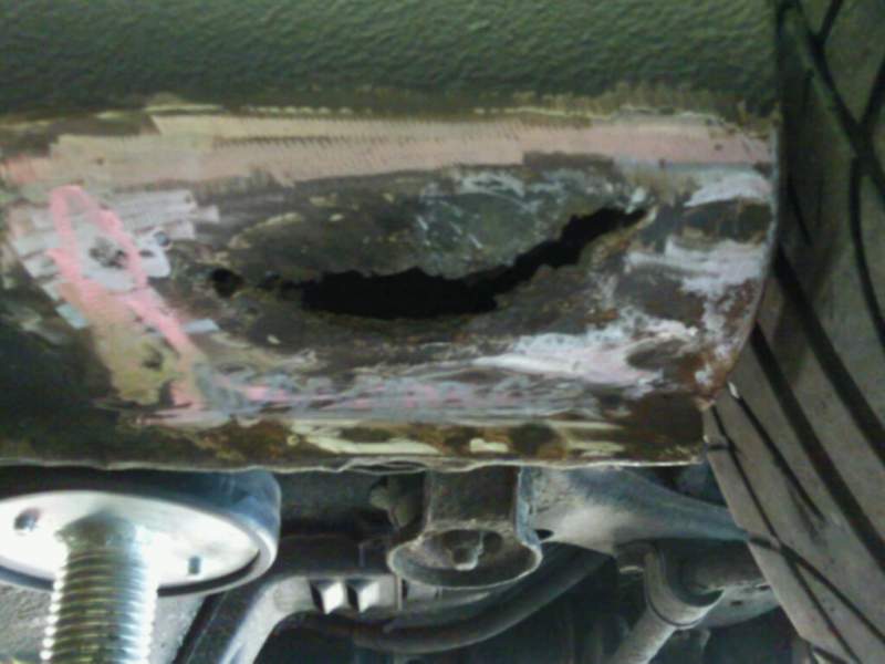

This was mine last weekend :(
All welded now, but needs finishing now.Earlier this year it had both rear quaters done as they had completely rotted away, the front crossmember was refabricated as well as a few other places.The sills are being finish the weekend after next along with a scab on each rear arch and a few bits around the rear lights.If you find a good welder most things are repairable......just depends how far you want to go!. :)

Looks like your seat mount reinforcement plate is coming away, did the drivers side on mine.
It had virtually rotted through. Could not see the total extent until I stripped it back.
Maybe something the MOT guys will pull you up on?
