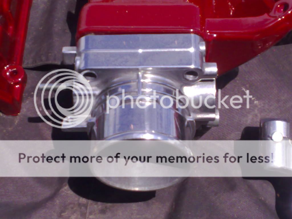

This is how it will look after a good hr of polishing.
Worth the effort me thinks.

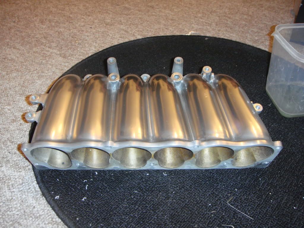

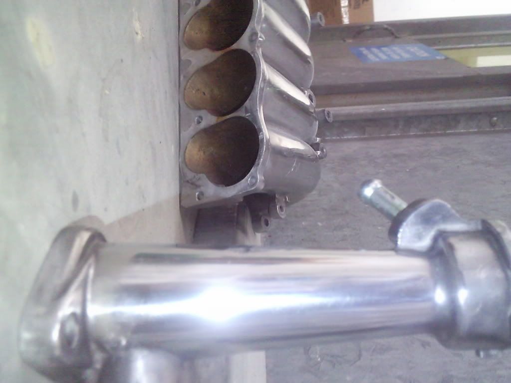

Took me a total of 13 hours to do my FTO Plenum (by hand mind....):
mind you did the thermostat in that time, I forgot about that till I saw the pic. Was hard work by hand.
