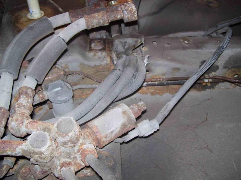

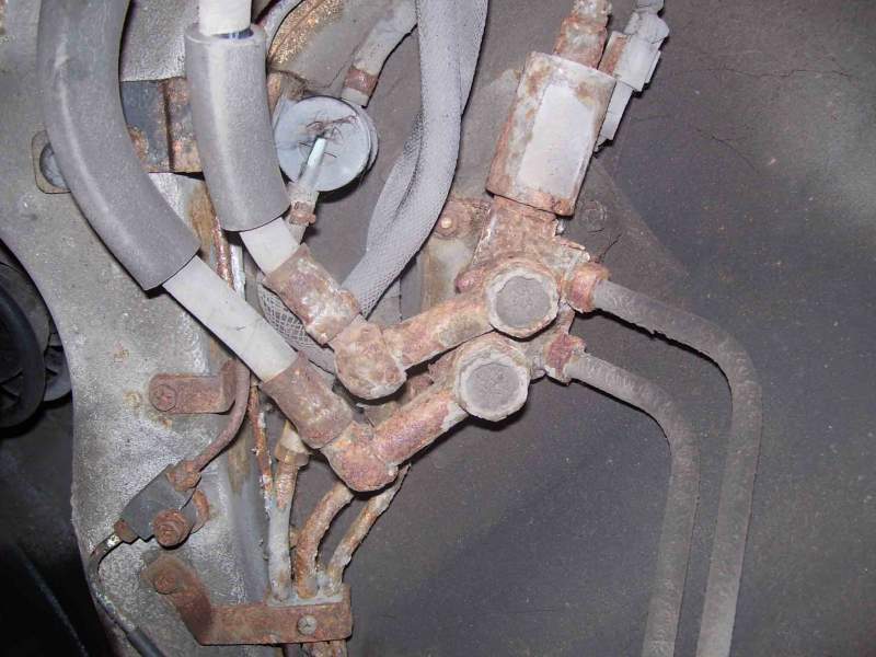

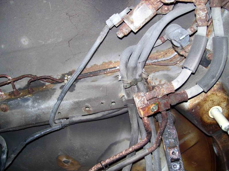

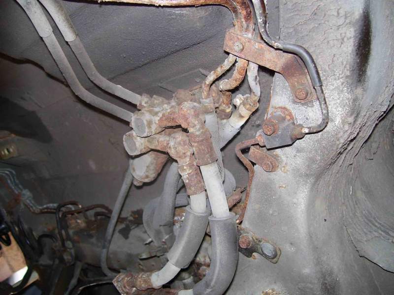

By chance I did get a couple of pictures of part of the HICAS pipework if that helps.
The last pic shows the block that I mentioned, looks like it unbolts from the underside and that theres room to do the job without dropping the subframe. Hope I ain't wrong :)
Had a look today at mine, seems pretty straight forward.
If you look between the n/s drive shaft and the rear of the subframe you will see the pipe assembly mounting. An 11mm or 12mm socket iirc will unbolt it then its just a matter of the 2 banjo bolts above the front of the drive shaft and the two connections at the ram. By the look of it there's no need to drop the subframe.
