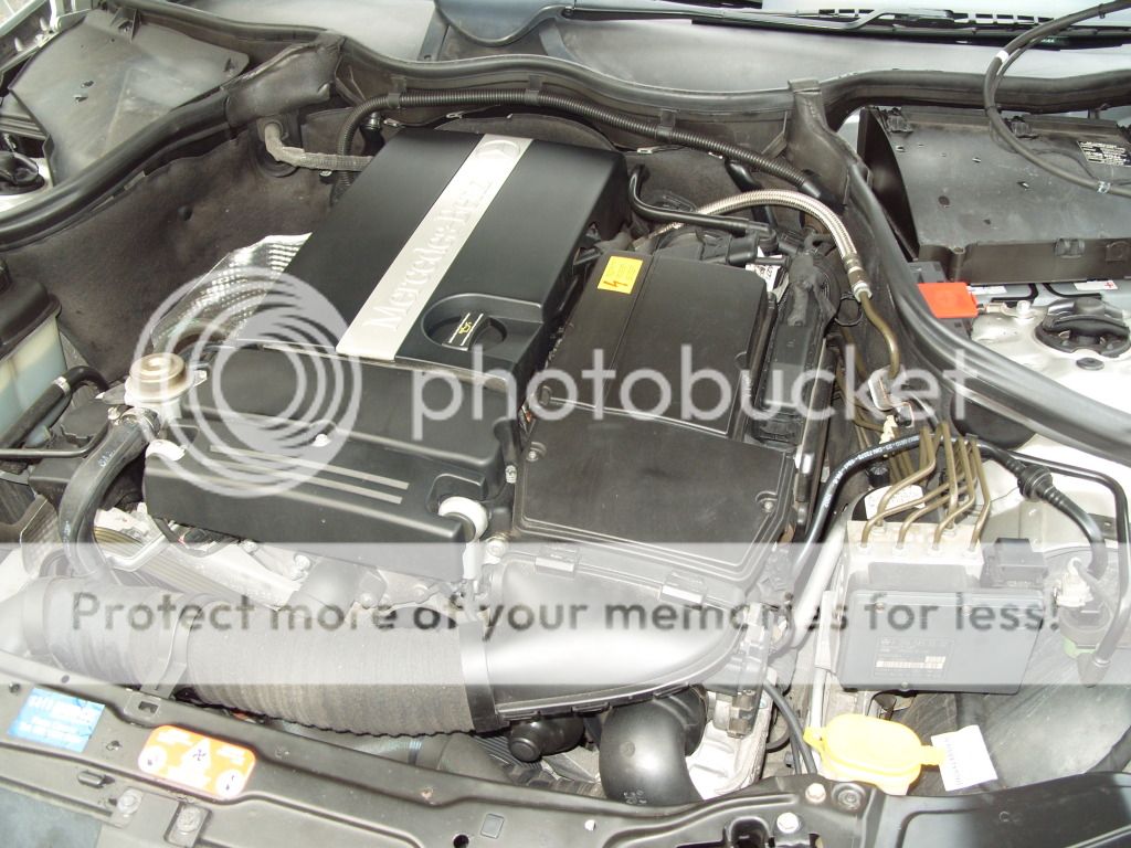

A Mitsubushi engine?! unless someone has been very brave/stupid with an engine conversion I would guess at your year you should have the Mercedes M271 engine, similar to this one:
That looks like it Paul and he called it a Mitsubushi engine I looked puzzeled at him and said "Mitsubushi!" and he said yes a Mitsubushi engine. May be he ment that the Mercedes engine had been fitted to some of the Mitsubushi models either way I will have to do an oil change mate.

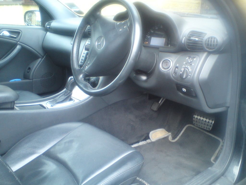

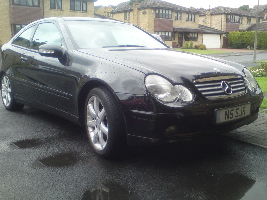

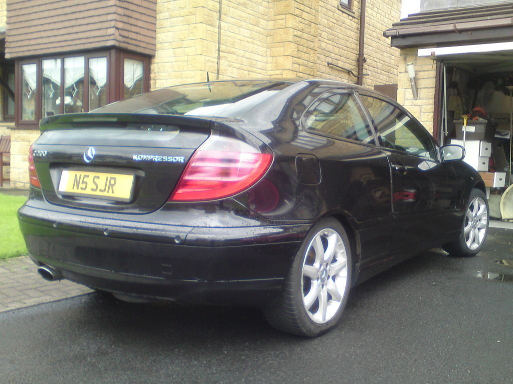

Well as promised Gaz some pics below, we have owned the car for about 6 years and is the sport panoramic version so it's the CL203 version of the W203, hence the mats, pedals, 17" alloys, etc.
