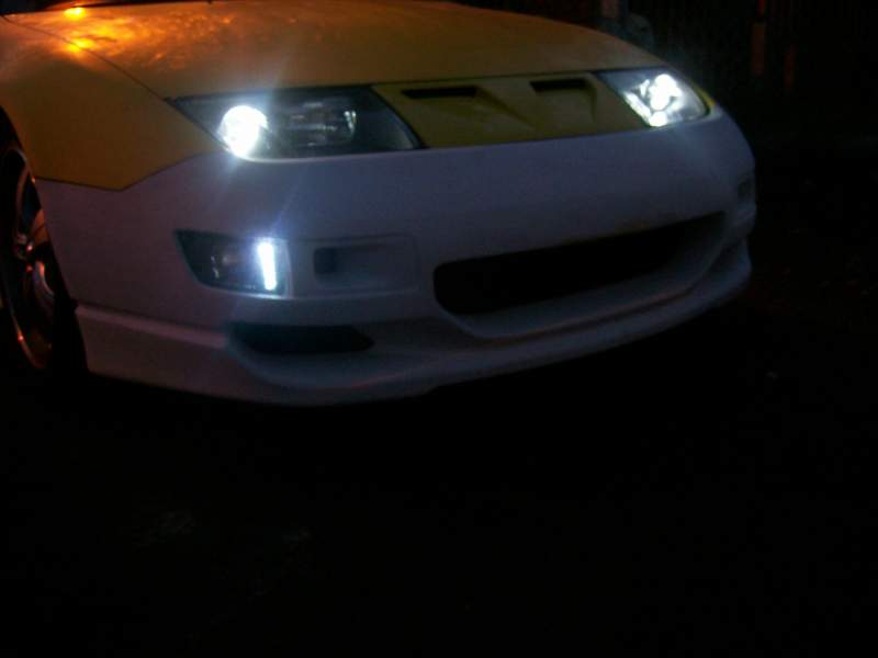

I used normal 5mm white leds, i placed a 470 ohm resistor on each one, as i didnt want to lose a row of three if wired in series.
I drilled 5mm holes which makes a nice tight fit, then hot glued and sealed the rear of the leds/wiring
Edited by groover

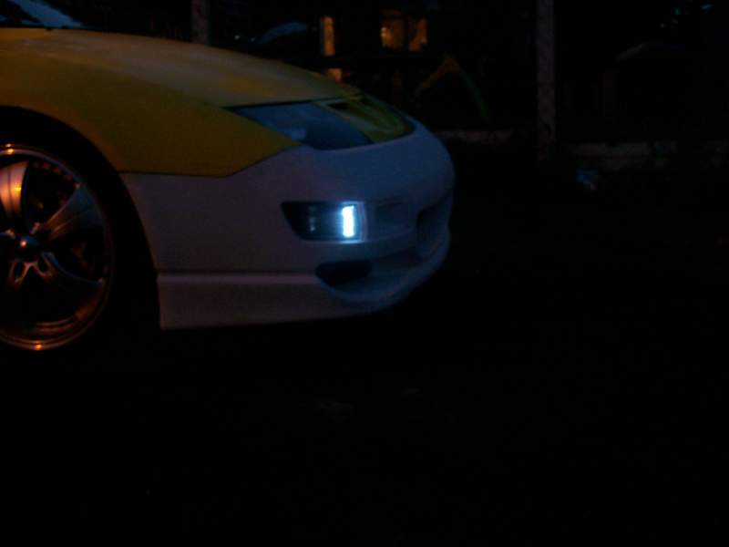

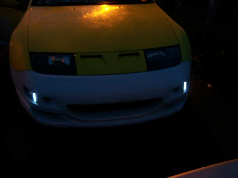

Done it .. i used two 3smd/led light strips in each unit ...
so theres a total of 6leds and all will run independent
Cool, the only reason i didnt use the strips is the spacing of the leds are too far apart for the effect i wanted.
i stagged the leds over both strips so theres led about 5>7mm apart
looks all right i will try and a pic

its not on the car yet ...... but in that pic u can see its got an Flar edge to the bumper now
Yeah already noticed that. done a super job blending them in :cool3:
