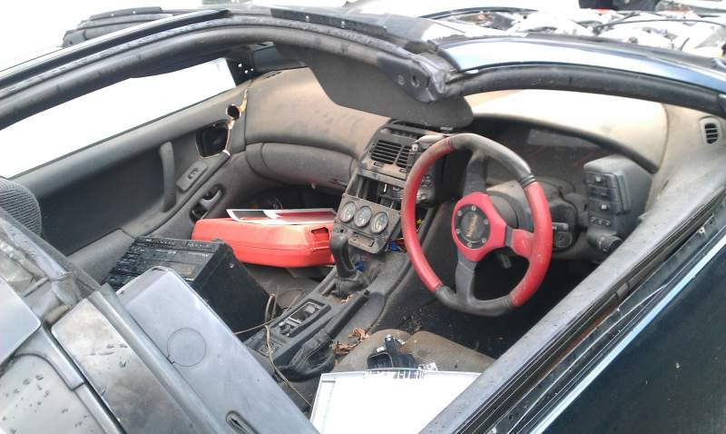

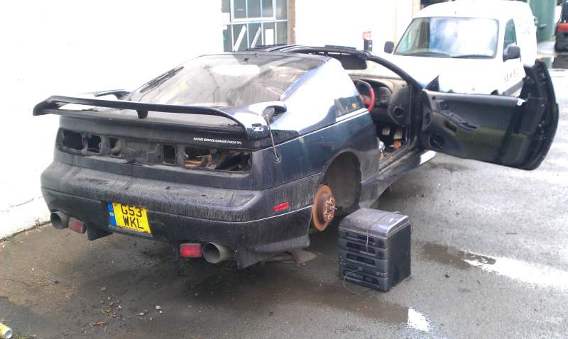

I start with this.

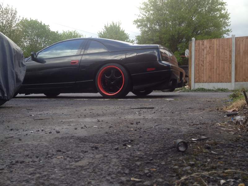

and this si what i got now.
its unfinished now but hopefully 3 weeks time will be.
