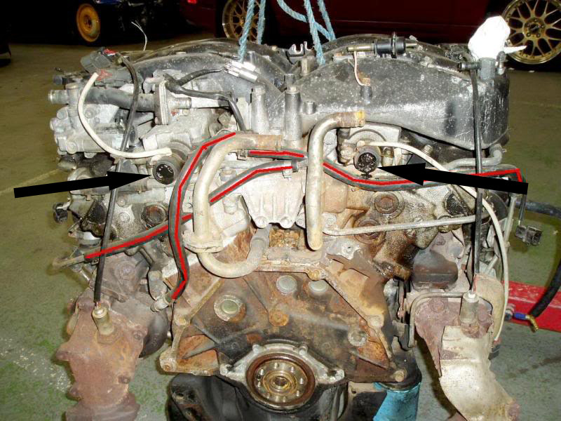

Faulty VVT solenoid on the rear of the engine?
Thanks Steams,
Are they easy to get to? Would be keen to have a look at the connectors etc'
Thanks Steams,
I've borrowed this picture from one of Jeff's threads, the valves are arrowed in black. I don't know if this is your problem but it's worth checking out.
HTH
sorry about the other picture but I can't seem to delete it :(
