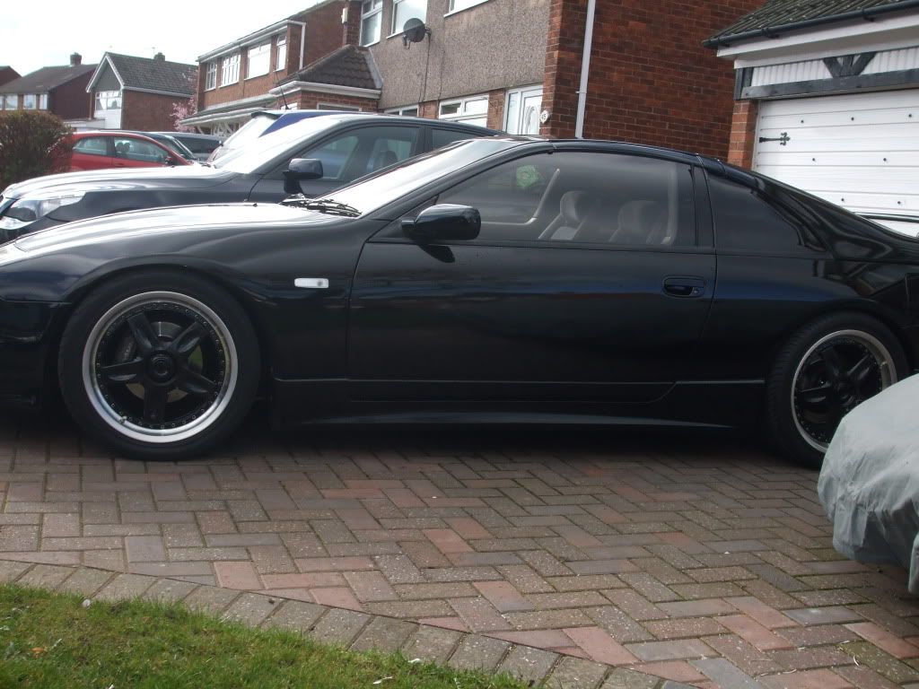

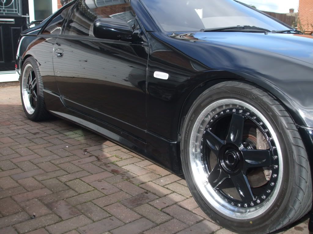

Pictures added, got BC coilovers, stiffest setting and they still catch.. might raise 10mm and see what happens..
they're catching on your guard..... Rim and tyre are WAY too far out for how much camber you've got. you'll have to get your guards rolled. just to fold up the lip that steps inwards.

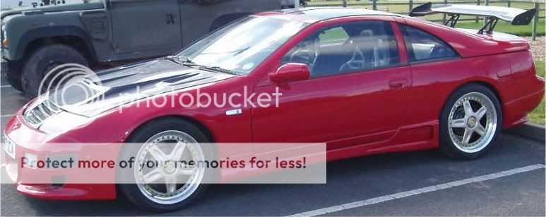

here's a pic of them on the LWB fitted with TEIN's and DW camber arms
they look like 245's on the front which were the same I think?
They are catching on the front and the back. less on the back though..
there is some adjustment in the factory camber arms, and factory rear toe bars on an n/a toe can give u of more room if done right, but of course understeer/oversteer depending how you set it, if you have hicas it could be wreaking havoc in this department, and with all the altered suspension geometry it won't be working as it should anyway.
They are going in for 4 wheel alignment next weekend. You can see the camber is not right...
All new to me this, so playing to try and get it right...
