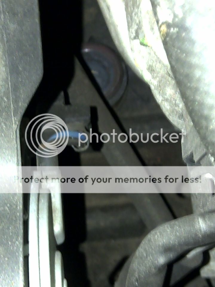

then less than 24hrs later I'm waiting for the AA to turn up just after leaving bobgenie's place as the the Grandis decided that it didn't need it's alternator pulley anymore and opted to send it flying around the engine bay instead!
so eventually (after 3 different AA vans/transporters) I dropped the MPV off near the Mitsubishi garage and the following morning asked for a quote.
Mitsubishi wanted £450+ in parts and £100 labour
ebay wanted £100 for parts including 8am delivery next day....it was a no brainer, Mitsubishi fitted my parts!
