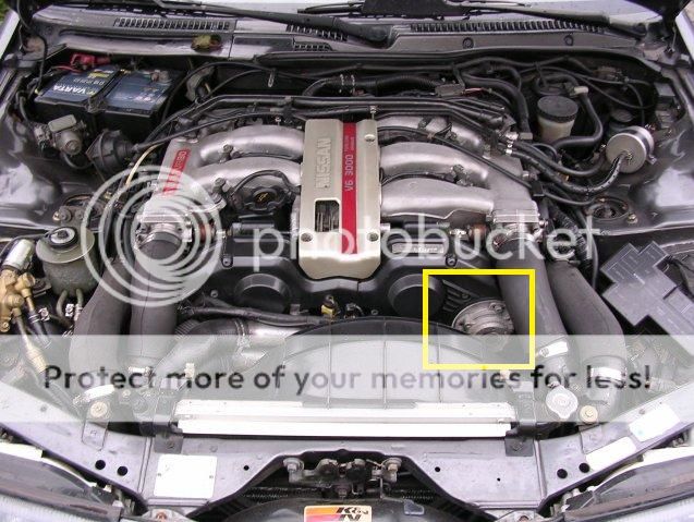

I know what/where PTU is - I mended one in my last Z. What/where is the CAS?
Ta
on the front of the engine lefthand side as you look down the front of the engine in the middle of the cambelt cover.
....i think
....i think
Nearly-on the right cam belt cover as you look at engine............
yeah sorry i meant as in left hand side as the car faces.
*waits for the awkward moment when it isnt that*
yep thats the one mate
