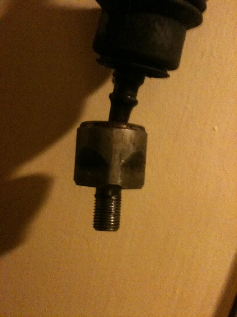

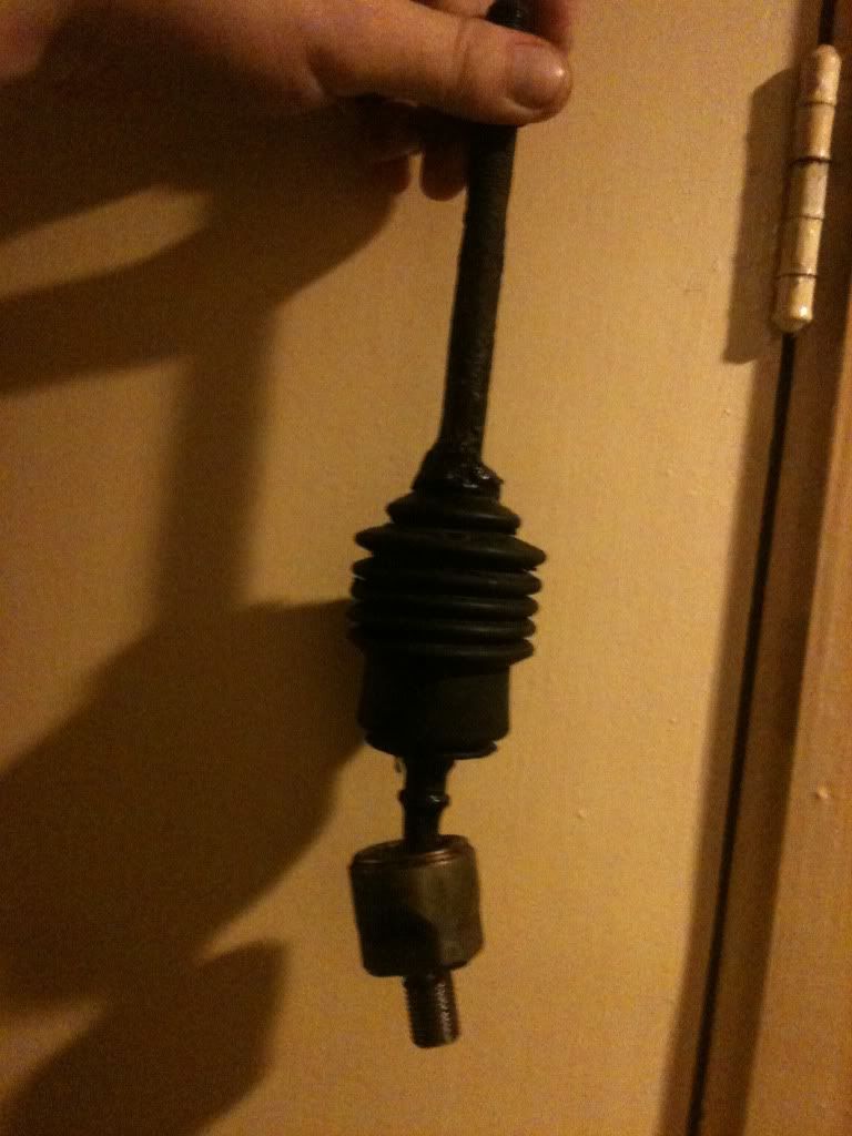

one sec ive still got my hicas arm under the kitchen sink, ill get a photo of the bit im on about, but in the mean time, if you rotate one while looking at the other, you should see it turn.
Hicas arm, on the end is the big bolt that secures it to the actuator
there is a locking section as well (not in photo), but if you stick one spanner on this (the large big square bit) and one on the other side, they basically undo each other.
