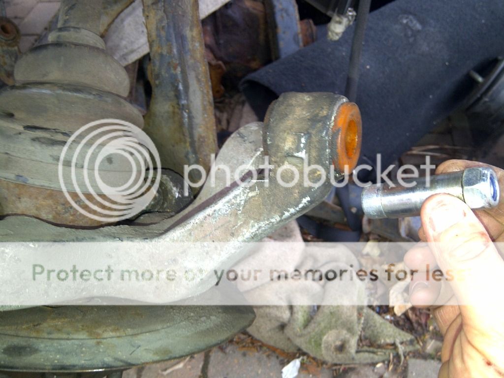

The DW HICAS kit was previously fitted to the LWB, and the bushes are still fitted
am I likely to be able to get these out intact or do I need to replace them, they haven't been used just fitted

Its a case of grinder and cut the end off then hammer out. Some heat would help the job but they are a pain to get out.
and it was all going so well :headvswal
The only reason to grind the end off is you can't really get a hammer in from the other side to knock it out. Or get a hydraulic press as them things are damn tight in there
DW bushes should come out easy. Push the metal inner out first then the two halves should come out easy. Nissan OEM balljoints were a different matter. I took the hubs off to do it and used a press...easiest way (not shortest though!)
Easy when you know how, cheers mate
I used a stubby nut and bolt just to give me something to tap
took all of 30 seconds each side...

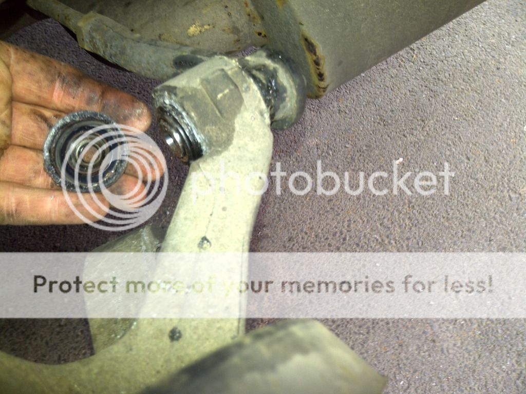

now the OEM bushes....hmnn, not so simple I think

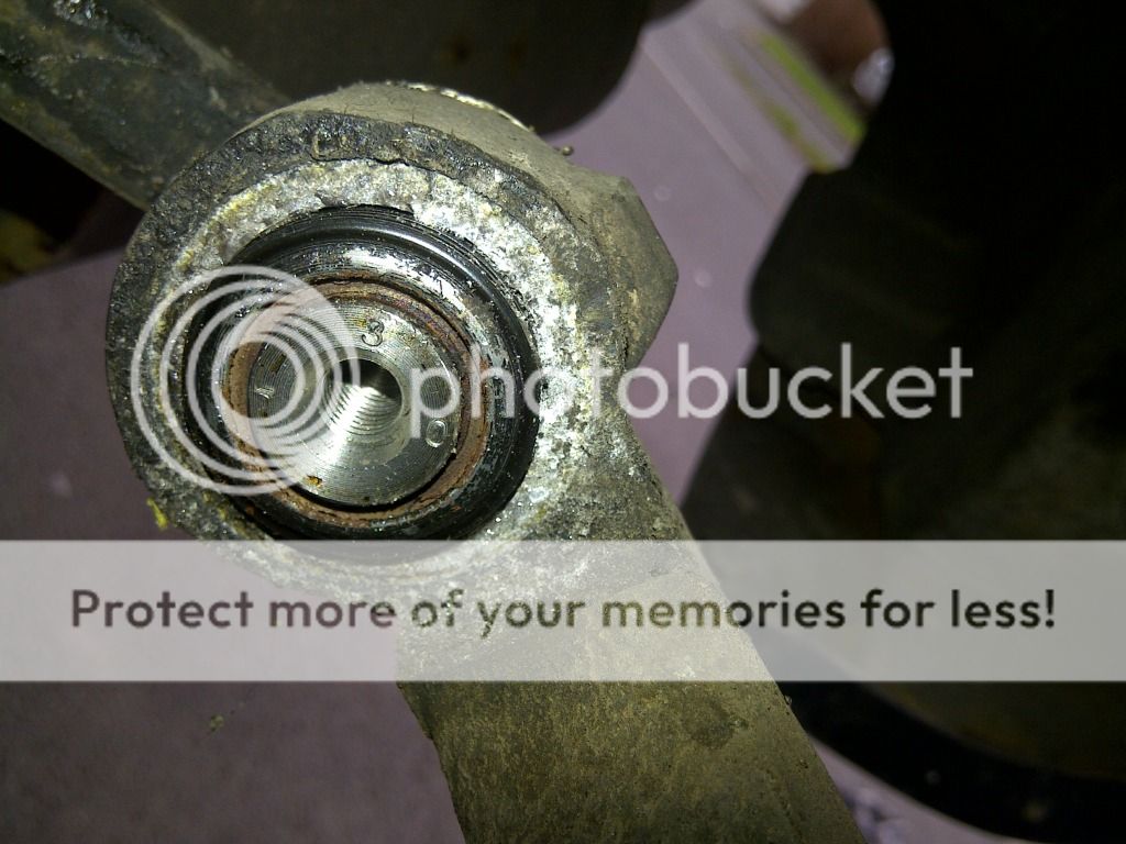

Looking inside there it appears to be threaded, can these just be un-screwed rather than getting a grinder on it???
you could try putting a 10mm bolt through and a big socket at one end with a large washer and nut a keep cranking the nut and see if it will pull the bolt and bush through. spray it with wd40 first.just a suggestion but worth a try mate.
Well I've had another go and still nothing, can't actually remove the HICAS arm (is it threaded on?)
This is a 1995 SWB (electric HICAS) and the ball joint on this looks completely different to those on my 1991 UK spec LWB (hydraulic HICAS)
are the later models ball joints configured differently?
The thread inside the ball joint is just for the end plate to screw on so the ball joint can't 'fall out of the hub' (yeah, like that's likely to happen eh?). They are an utterly royal pain in the arse tho, I managed one using the grind off the end and bash it through method, but for the other side I removed the hub (easier than you think IF you can get the big nut off the end of the drive shaft, if you really can't, you can undo the drive shaft from the diff, just mark it so it goes back on it the same place) and took it to my mates and used his hydraulic press, was off in less than 5 minutes... You could also try grinding off the end and using an air chisel/hammer to knock it out, would be easier than swinging a lump hammer about...
