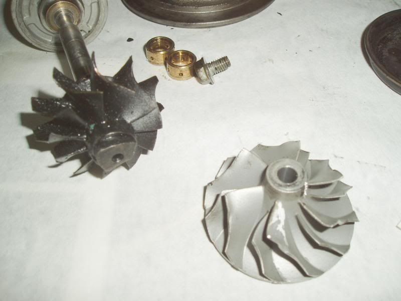

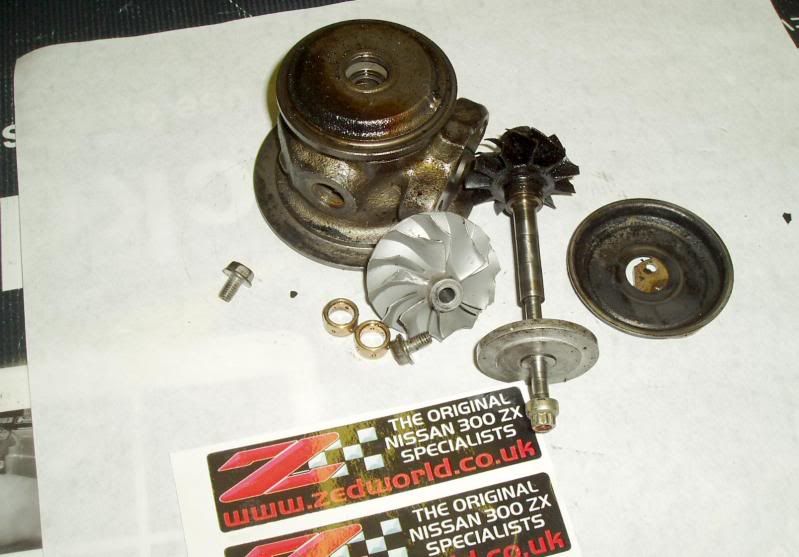

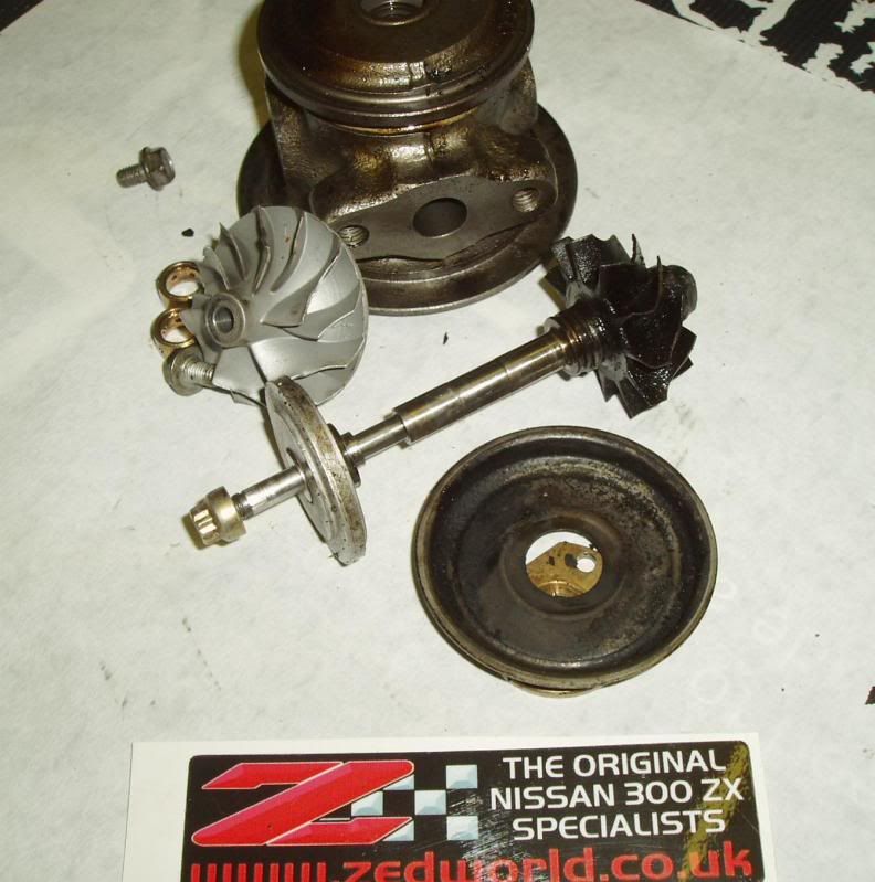

So here are the oily bits,
Damage to the intake impellor due to failed bearing leading to excess shaft movement, exhaust turbine can be seen covered in oil due to rear seal failure after the bearing overheated.

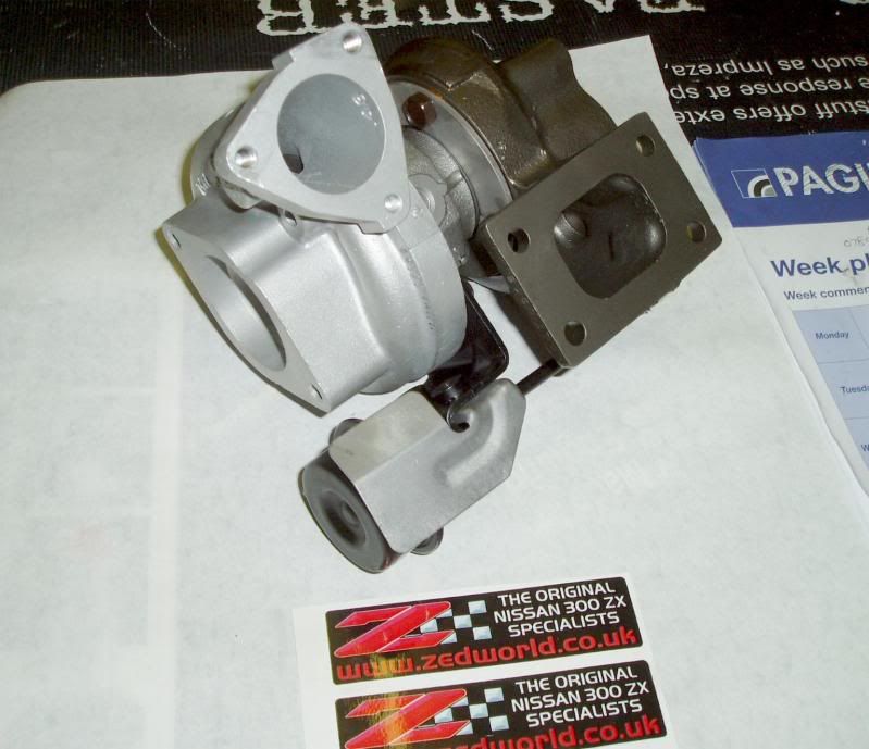

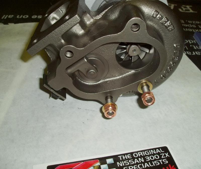

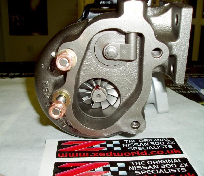

All refurbed and looking spanky, such a shame it will be not be viewable!!
A little under £400 and with all new parts and 12 months warranty so not too bad, now where does it fit?.......
