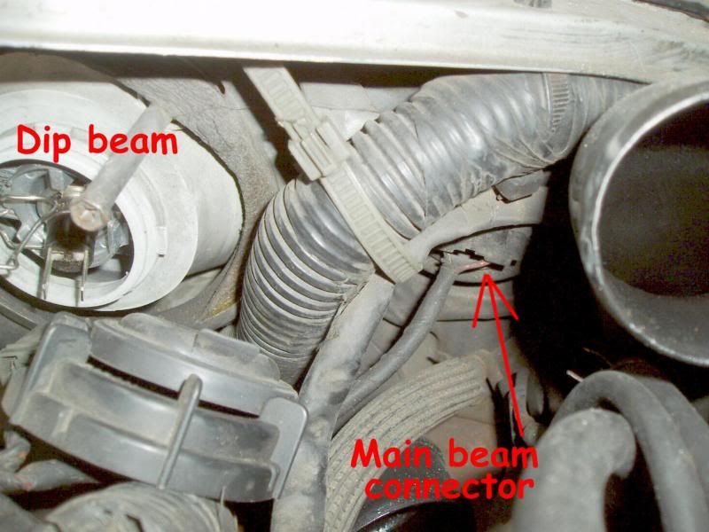

Main beam bulb replacement is difficult due to the closeness of the wring loom and the headlight configuration the first picture shows the location of the main and the dip beam bulb.
To disconnect the wiring connetor you need to squeeze the connector together and pull back at the same time.

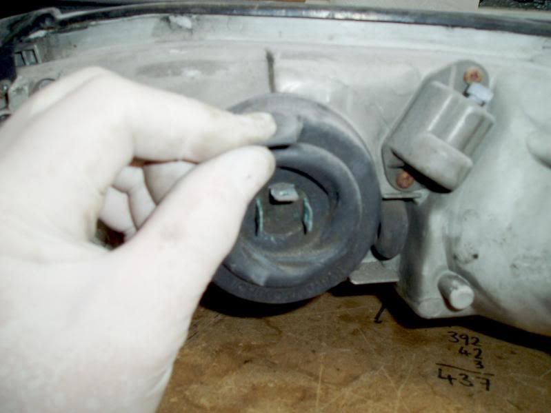

See in this pic the main beam pins and rubber cover

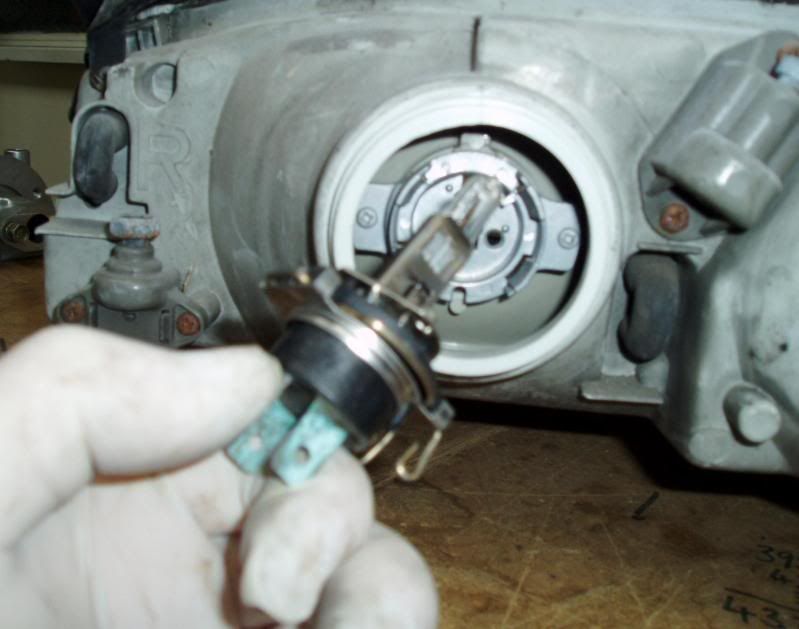

After pulling the rubber cover off the bulb adapter is removed by squeezing the two tabs together at the bottom.
Now the bulb and adapter can be removed

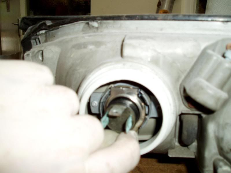

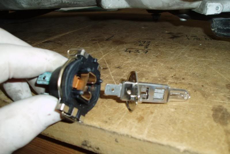

Pull the bulb from the adapter and replace with new item

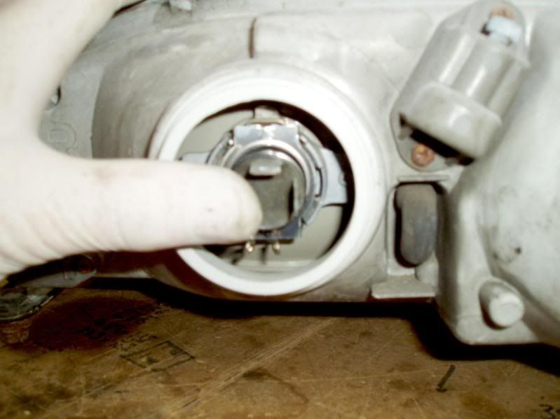

Once the bulb is mounted into the adapter return to the headlight, ensure the adapter release tabs are at the bottom, now push the bulb and adaptor into the headlight and its should click in, refit the rubber cover push the wiring connetor on, and there you have it.
