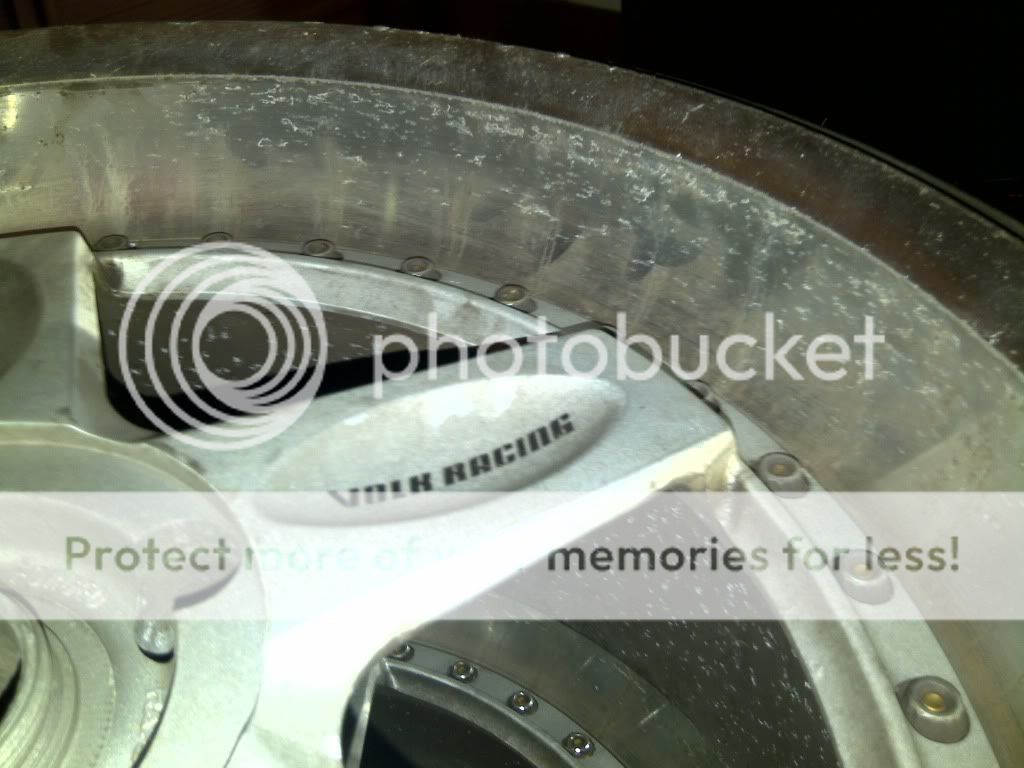

They are 3 piece but I plan to re-paint them in matching white enamel so they shouldn't look too out of place
The 3 piece rims are off an S14 drift car and as such one of the rims is a bit battered.
The outer lips on both are a bit dented and one of the 9" inner rims is cracked.
Therefore the plan is to use the mint inner rims and outer rims from my old black recently refurbed CV Pro 3 piece split rims (8" and 9") and cross deck them onto the replacements with the better ET +20 offset (the old black ones are also +45mm offset so again are not suitable without spacers)

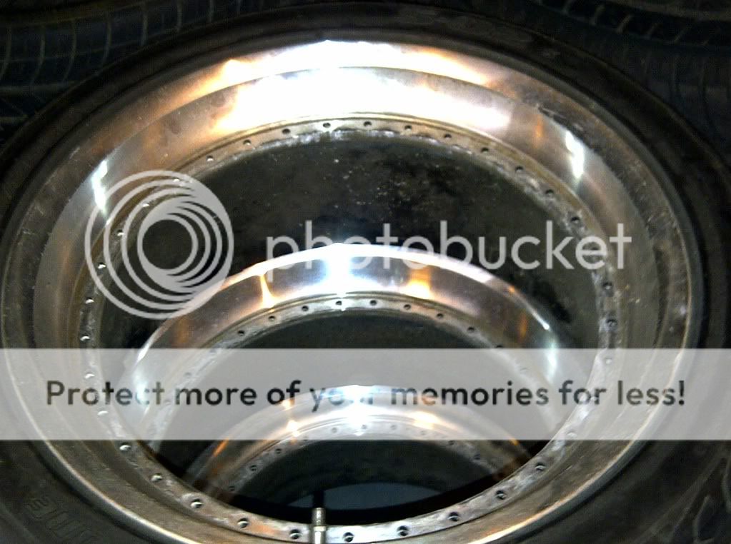

I have 2 x 8" inner rims that would bolt straight on
and
I have 2 x 9" inner rims that would bolt straight on
I also have 4 x outer lips that are immaculate and will bolt straight on
